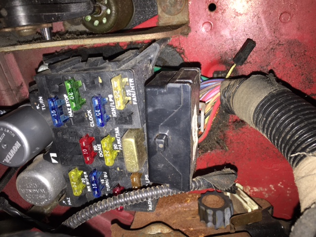

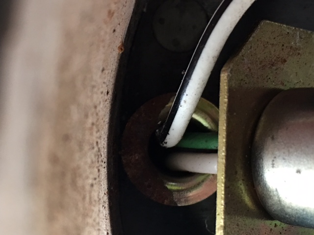

So I have cleaned as many grounds as I can find, the lights then self seem to be grounded by the 3 bolt that bolt the tail light fixture to the body. Only 3 wires, one white one for the reverse light and the other two go to the bulb thats acting strange. Green and one White/Black. Now all thats wrong is the wrong filiment is ligting up for the wrong thing, so that when you turn on the head lights its the brake lights, and visa versa. I am looking for ground you discuss and in doing so I have noticed that under the hood in the fuse box there is a flasher for the emergency blinkers, and then under the dash that fuse box has two flashers, I was assuming one was for the emergency and one for the signals? Any other thoughts, before I keep looking for more grounds to clean? Here are some photos IMG_4213.JPGIMG_4211.JPG

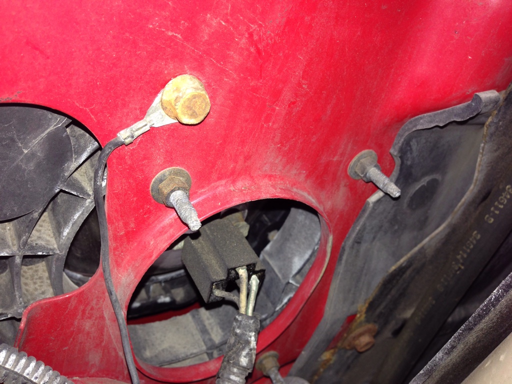

In the below picture there is a bolt just above the headlight that is attaching the headlight ground to the body. This is the driver side. There is one on the passenger side.

If it's not the headlight grounds it is the multifunction switch. It's fairly easy to change. There is a U tube video by dorman on how to.
Thanks!! All my grounds are nice and shiny now, but this was not hte problem, but glad I did it as they were all looking a bit cororded, our salt air does that here. You are going to think I am stupid but here is what the issue was. The bulbs have those nipples on the side that are off set, to keep you from putting in wrong, well my driver side the receptical only lets you put the bulb in one way, the correct way, but the passenger side receptical is worn out and you can put the bulb in either way with ease, and thus causing the contacts on the bulb to be on the wrong contact for the wires.....now why this makes dash board lights go on when you hit the brakes I do not know but it makes since as to why the wrong filiment would light up for Brakes/Driving lights. Problem fixed. Thanks for all your help!!!
