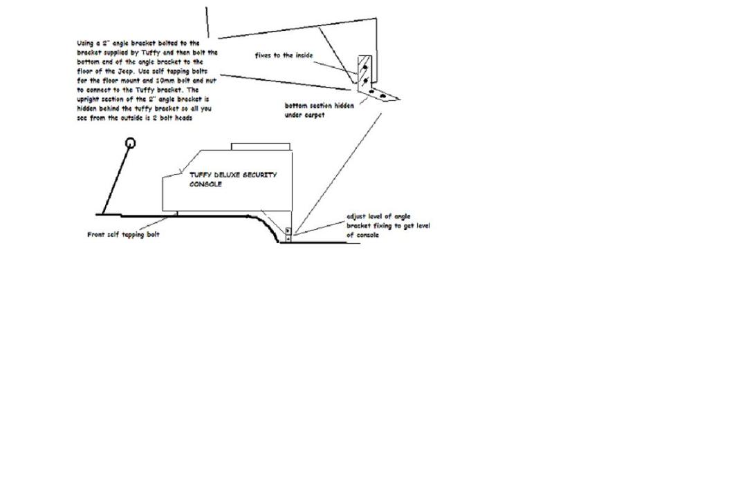

Hi
Has anyone here fitted one of these Tuffy security consoles before. It looks like they bolt through the tunnel, but i can't see how you secure the nut from the underside, as the gearbox appears to be in the way?
Any suggestions?
ps it is the deluxe stereo model with drinks holder etc
cheers Stew:?|
Pretty good bit of room between the tunnel and the transmission. I've got tuffy's in two of my 3 Jeeps and they're attached with two bolts in the back and one in the front (all three are accessed inside the console). None of the bolts interfere with anything under the Jeeps.

Yes, the underside nut is right over the transfer case on mine. I cleaned a spot off on the tub and spot welded the nut in place b/c it was such a pita to get to.
got it in o.k, i used a self tapping bolt for the front bolt and a set of angle brackets on the back fixed to the bracket they supply. This has made the console sit better in the jeep, more level, and is amazingly secure, as it should be. I must confess that i left off the drinks holder as this seemed to get in the way fitted either at the front or the back.
Once it was all in i looked at the gap between the transmission and tunnel again and realise there's a lot more room there than i thought, but still prefer my installation method.

Pics or more detailed description please.
I've got a newer Tuffy in one Jeep that fits perfectly, and an older Tuffy in the other Jeep that sits really low and makes leaning on the armrest a bit less confortable than he newer one. I've thought about taking the older one out and modifying the braket on the back to raise it up a bit.
No photos of the installation as it happened but have attached a drawing showing the method
