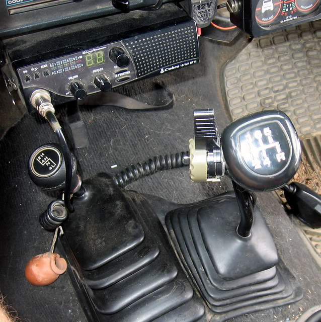

It looks exactly like a gear changer on a mountain bike.
If I get it installed this weekend, I will take some pictures.

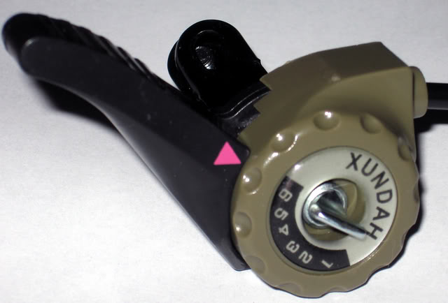

This is the thumb throttle that I bought.
It is made by 33Engineering and was purchased through OffroadToyStore.com
It attaches to the manual shift stick. Came with an eight page instruction manual. Pretty thorough installation instructions.

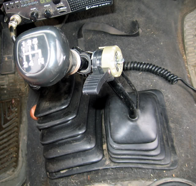

The kit came with two adaptors (angle irons) this one fit like a glove...

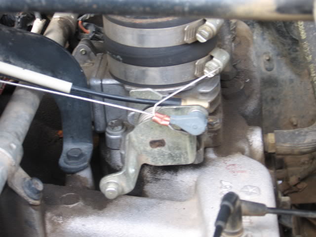

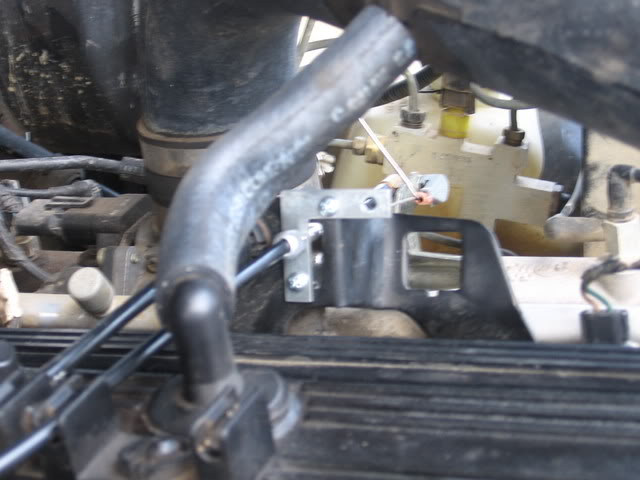

These are the connections to the throttle body...
Easy to install! Works great! Now all I need is decent Winter weather (is that an oxymoron?)
