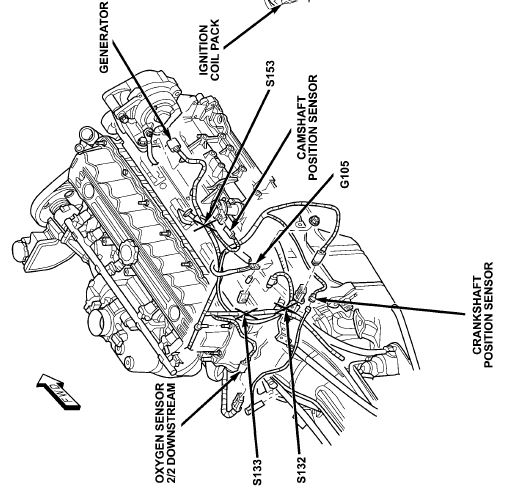

But with those 2 codes you want to check CKP - the connector and wiring, shake tug harness when testing ....
Do you need a wiring diagram?
FYI If you replace CKP get part from jeep.

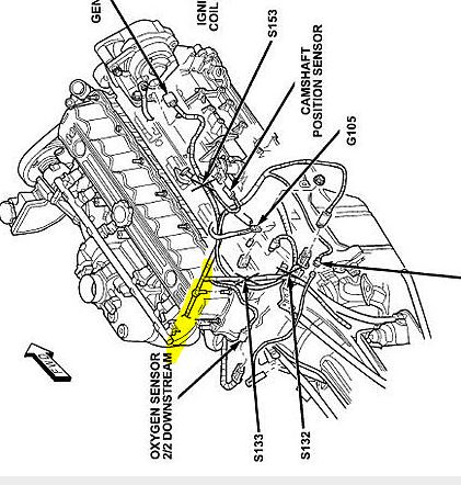

check for wire chaffing at the indicated area -
wil follow up thursday
