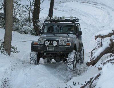

I have a Kargo Master rack for carrying extra gear. I really like it because you take out the two bolts on the front and the entire thing swings up over the jeep and lays on the ground to the rear, making it easy to change tops or put the soft top up/down. I also have 4 500w Helas mounted to it. I just bought a plasticized piece of box tubing from Thule and bolted it crosswise to the cage with 2 u bolts, then bolted the lights to it. The wiring runs down into the cab on the driver's side and connects via a 4 prong trailer light wiring harness, which makes it easy to swing the whole cage back. After lifting my jeep, I carried all 5 rubicon tires/wheels on the rack for about 30 miles, so it will carry a lot of weight. The bad thing is at highway speed with a lot of weight, it oscilates back and forth and gets a sort of harmonic motion going which I really dislike. However, for carrying 4 pair of skiis and 2 big waterproof foot lockers with stinky ski gear and boots for 4 people, it works just fine. It's also easy to crawl up on top of and stand/sit if you'r spotting game with binoculers, etc. Hope that helps.
