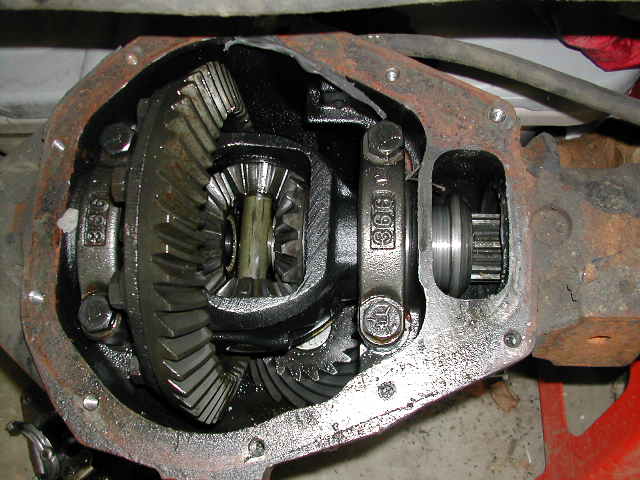

Isuzu Rodeo rear D44

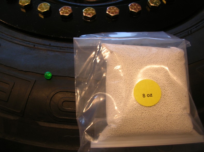

Bias TSL's in the Q78 size (35.5"x9.5"), internally balanced by Dynabeads

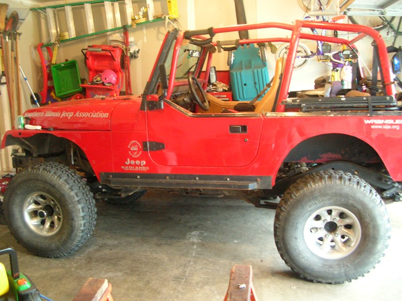

Here it sits on the 35" street wheels, as it'll only fit into the garage with these tires and no top:

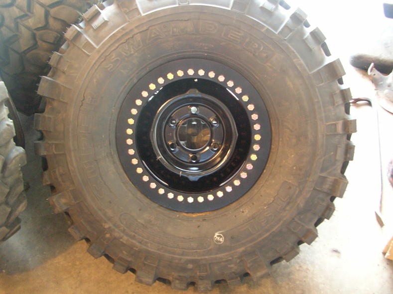

The beadlocks I'm working on, welded to 6" Waggy wheels for a 7" wide finished wheel:
My 8oz. pack of Dynabeads that went into each TSL for internal balancing, shown next to one of Pepper's airsoft BB's that he put into his TSL'SX's:

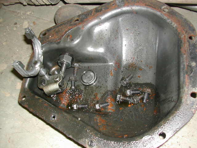

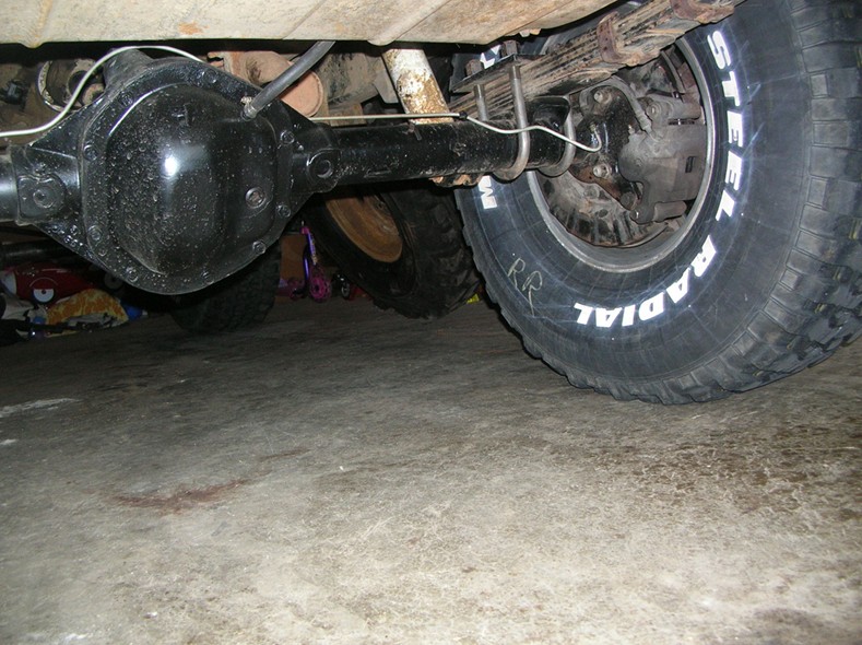

The Isuzu rear D44:

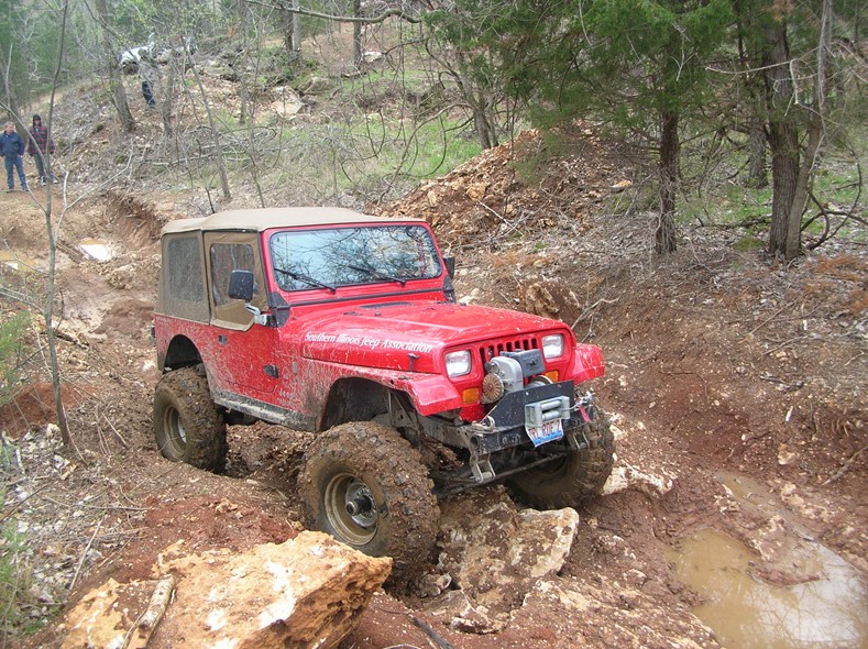

We had to winch a CJ5 sideways on the obstacle in the first pic, at one time it was on the fenderwell header and another it was on the fiberglass rocker. We got it through with minimal damage, sideways winching during forward progress. Awesome wheelin at Hannibal Rocks, Hannibal, MO.
