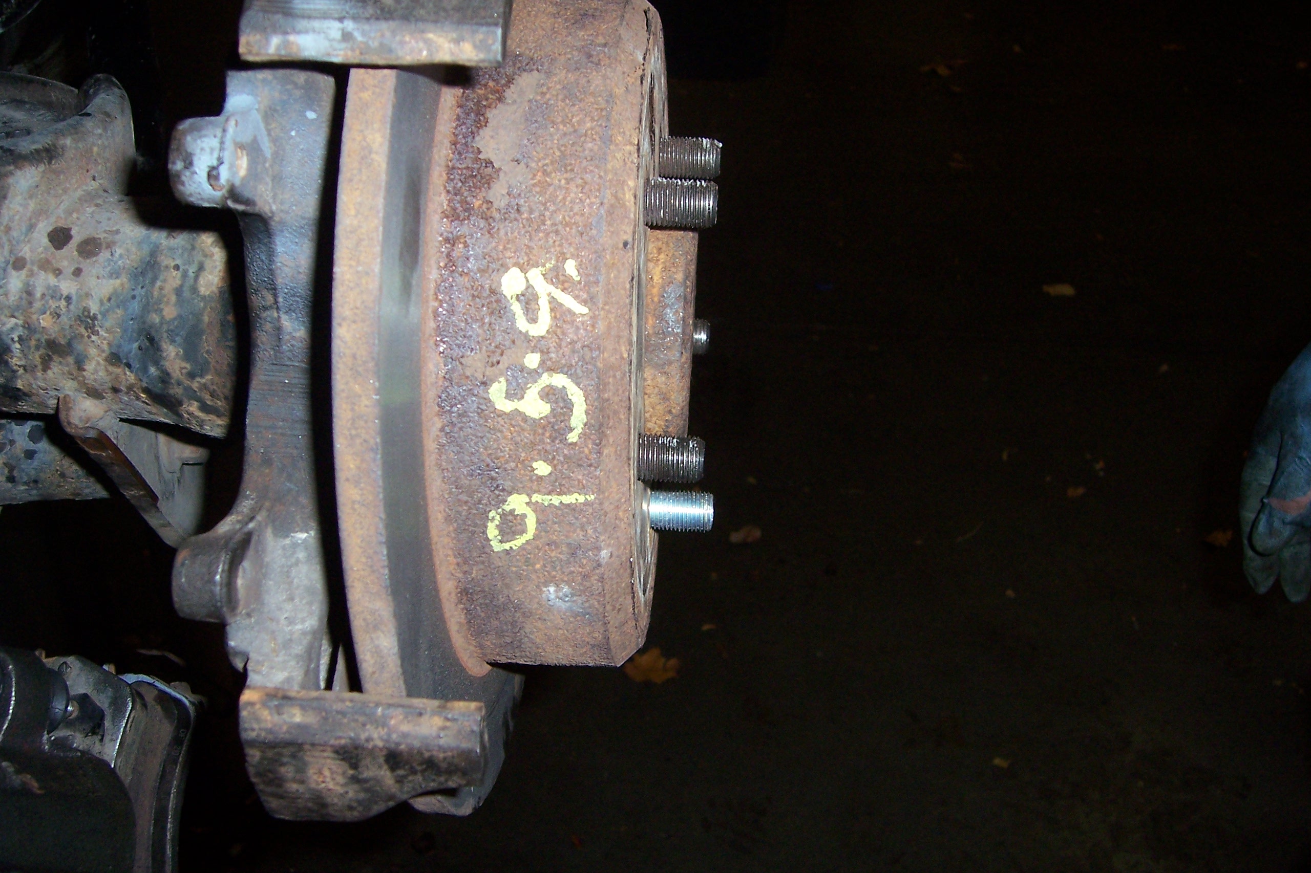

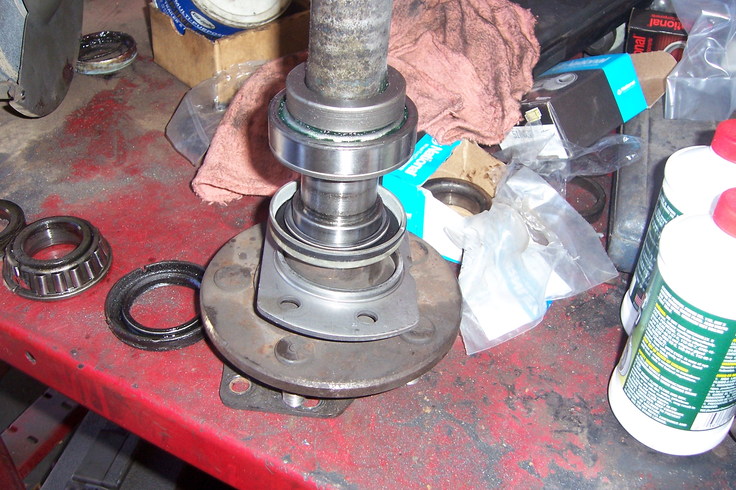

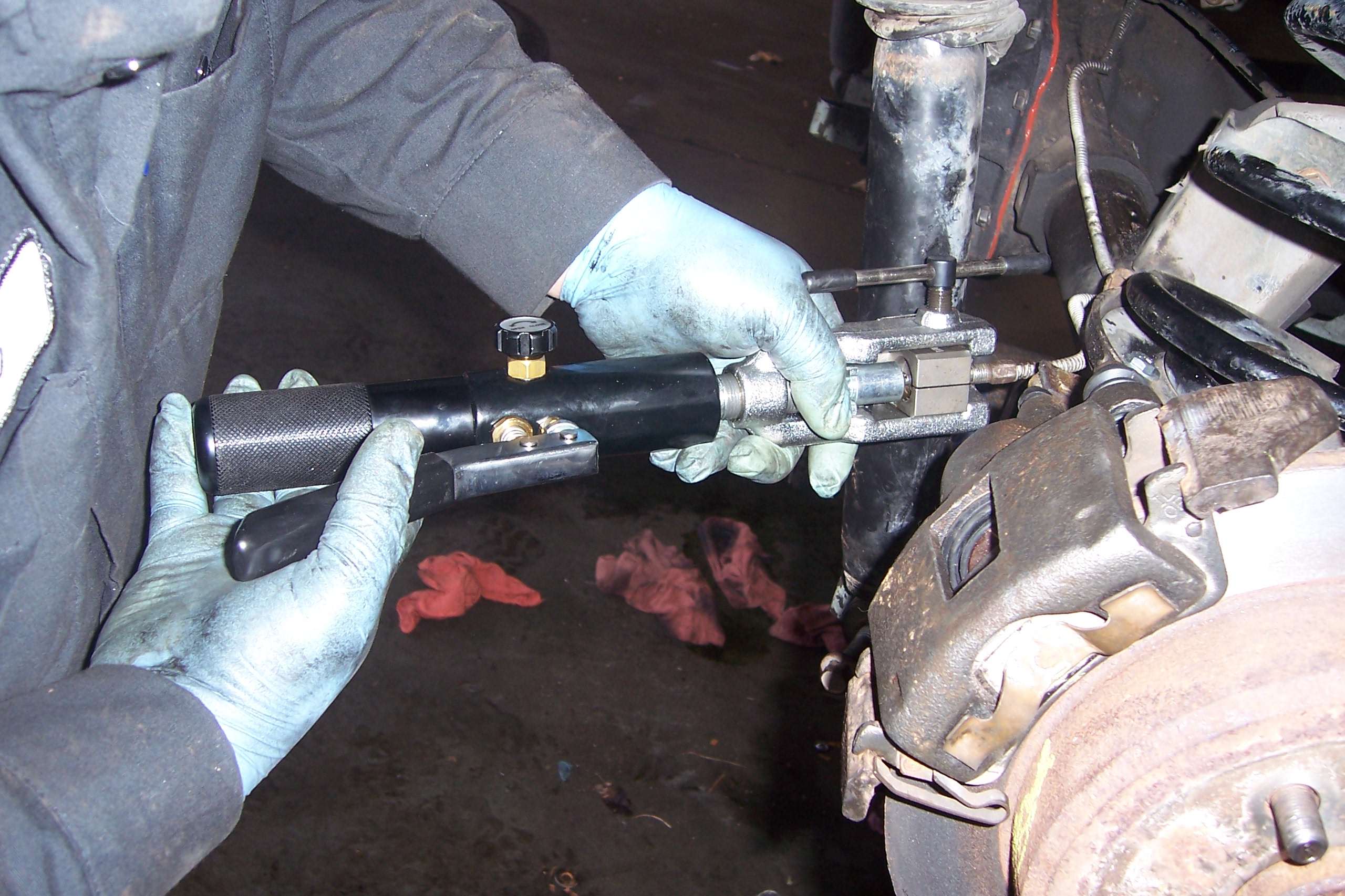

The E Brake Assembly off a 98 grand Cherokee will fit your YJ clip and mate up for the rear e brakes. I stole the whole Assembly off an 98 grand with Dana 44 (alum) with disc brakes, the only things I had to buy were the new retainer plates and longer studs for the axles since the disc rotors are thicker than the drums.
You will have to cut the hard lines to fit then re-flare them. Not a problem just take your time here. The last thing you will need is a manual proportioning valve, to set the bias for the rear discs.
Thanks, the pictures are great and will help. The guys up in Casmere, Wash. that built the 44 for me actually found a outfit that makes the cables up for my YJ and now the kit is complete and in a week the project will begin. There is a lot of input as to whether I will need a new Proportioning valve and one off a 4 wheel disk TJ or Cherokee has been suggested. I guess I will know when I get it together. Thanks again. Gary
