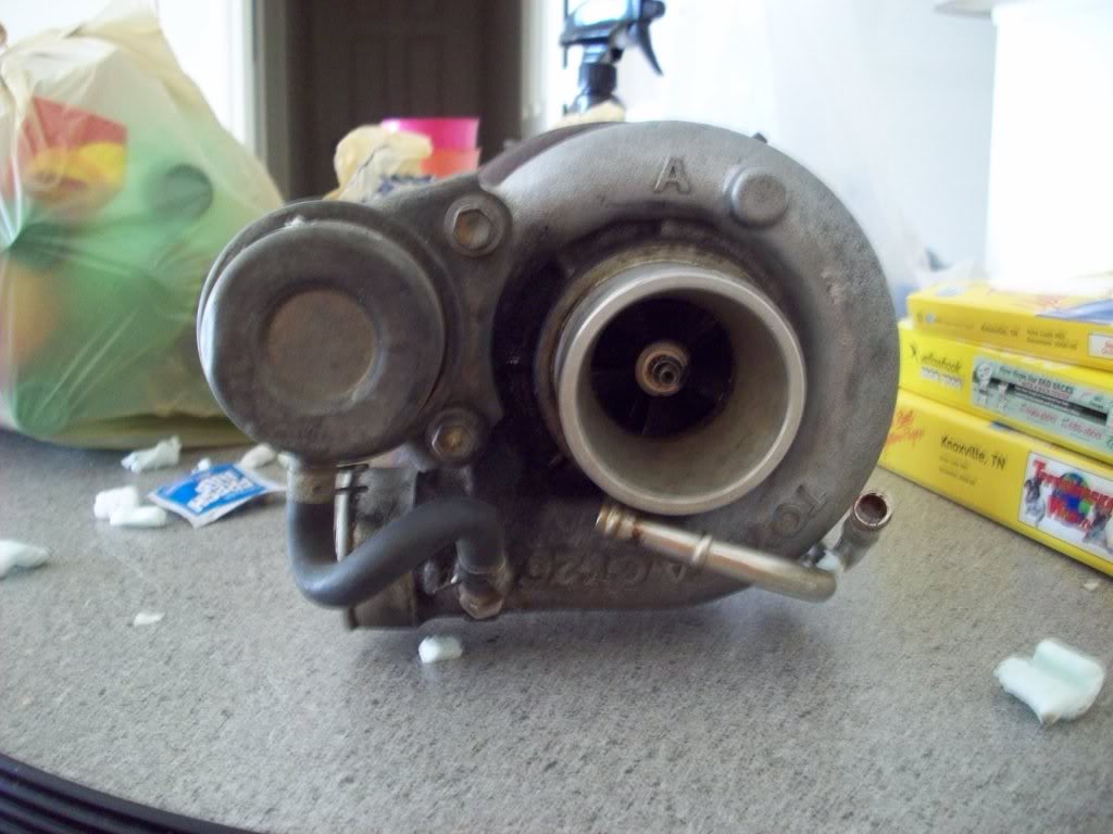

I'm selling my supra to fund the FTC-1. Right now I'm trying to find a fmic small enough to fit in front of the radiator. The cheap fleabay intercoolers are 27 inches long and I can't find my tape measure but I'm pretty sure I can't get that to fit. Anybody know of a 2.5in wide fmic, maybe stock from another car, that would fit in front of the radiator? Oh here's a picture of the turbo.

Well the project has been put on the backburner while I fix some drivetrain issues and I got tired of getting stuck so I went ahead and ordered a locker too. The turbo in the picture is a ct26 from a toyota supra but I have since come into possession of a hx30 turbo from a 3.9liter 4bt cummins. Initial plans are to run an extra injector off a hobbs switch and change to a megasquirt down the road.
