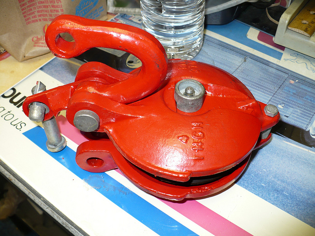

Excellent! I always prefer to err on the side of caution, I went back to Timber Supply yesterday after work and while they have several blocks of this type they could sell me they (two senior guys) emphatically hit their point that this block's working strength is four times what is cast into the housing.
I noted their 9k snatch block incorporated a 9" wheel
From Timber Supply: Most components (cables, blocks, hooks, etc) intended for self recovery are advertised at their breaking strength. The rating that is cast into the snatch block pictured above is likely it's Working Load Limit (WLL). The breaking strength will typically be 4 or 5 times the WLL, for a safety factor or 4 or 5 respectively.
Industrial applications will always have a significant safety factor but the recovery gear we typically use is not rated that way. Something to keep in mind when assessing the risks when rigging for a pull.

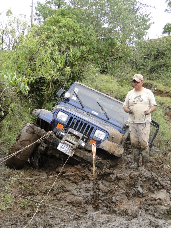

I use them; when you are up to the doors in mud, a 9,000lbs winch will more often than not have a hard time pulling you out. In fact, I was once in a ride where the mud was so thick and deep that it took 3 winches (2 with snatch blocks) to pull out a jeep from the mud... Here's the shot of that:

I now finally 'get it' the difference is between WWL and breaking strength. Some blocks are sold describing one or the other. Looking at the 20k blocks at Timber Supply they seemed not as robust as the one here. The guys said that those flat ones are intended for lifting rather than vehicular extraction. While they proabably work okay it's not thier inteneded purpose, according to them. Just as they were explaining this a log driver came in for some binders and remarked the same.

That's a good point; if you notice on the pic I posted above, I am using one to change the angle of mu pull (tied to a tree), Alejo is doubling his pulling power but using a snatch block on the Jeep (seen in the pic), and the guy in the blue Jeep (the one that's stuck) is using Alejo as an anchor...
