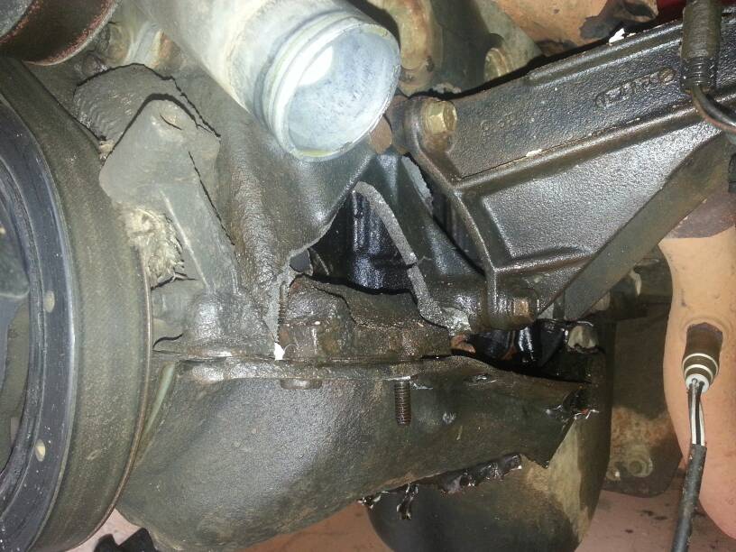

I'll have some pics, thee block is cracked in half. Including the crankshaft. The oilpan has a slight hole in it. I'll need a complete engine.
OUCH ! Got your monies worth from that one ! Another iron duke bites the dust , now I know why your contemplating a 4.0 liter I6 ! 2,5 , R.I.P. .
Well, what happened is quite a story but I'll give a brief example a let you imagine. 94 yj with a tow-bar. Mother-in-law hooks on to it to pull it off to work. Jeep is in reverse gear and no one knows the wiser. 160ft down a gravel driveway and 40 ft of pavement later with her pickup in four wheel drive because she said the jeep seemed heavy, and whammo there are parts and peices of jeep all over the road. :what:
Mother - in - laws , can't go there . Could we ask her to kick in some hard earned bingo winnings for a new engine ? Lol . Think she'll bite ?
Drivers side of the block. The other side is the same. Its see through! New motor and power steering components will be here tomorrow.
