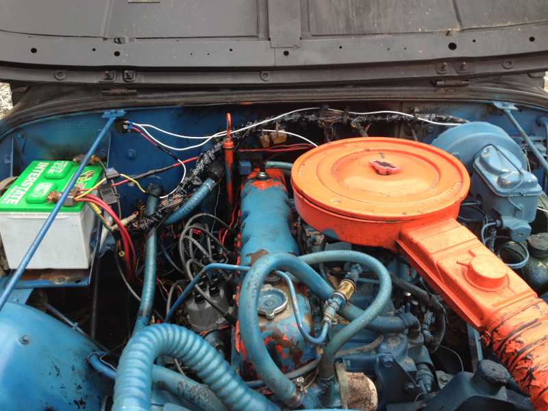

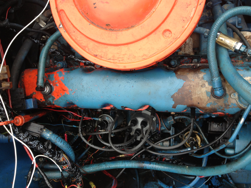

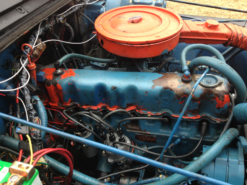

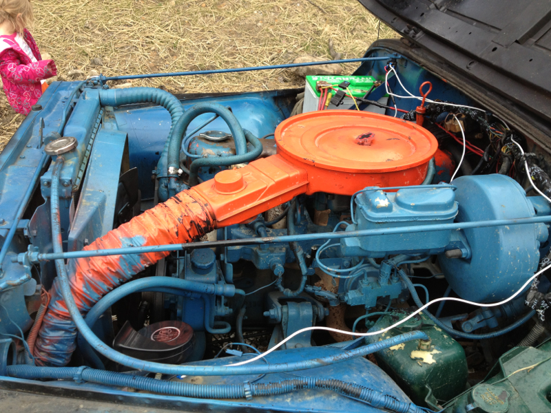

Well that's good to know... I've got a small oil leak on the top of the timing chain cover.. And I'm not sure if the oil filter I got is the right one because I went from losing a little oil when I drive it to a lot since I did an oil change.. I can take some pictures tomorrow if you tell me what you need pictures of unless you just want all around shot of the engine
All around is good, mostly the head/valve cover. If you put the filter for a YJ in, it's the wrong size. YJ filters have a larger base and an internal check valve.
I tried to match up to what was on it.. But wait till you see the mess of paint and wires.. I'm going to have to put in a new wiring harness eventually.. So no power to the heater and I had to wire up a new horn to get a sticker.. Lol.. What can I use to start getting that paint off but won't eat up my hoses and gaskets?
Maybe others have a better way of getting the paint off, but I took a rag and poured laquor thinner on it and wiped the motor down. Long process and wasn't fun. lol
Found the reason for my oil leak today also. There is a bolt missing in the top of my timing chain cover
