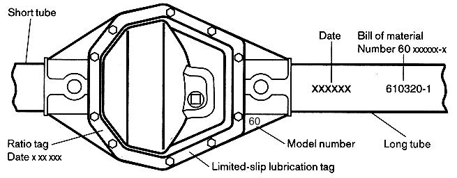

Im not the best with wranglers, but I believe your jeep could have came with either a dana 35 or dana 44 rear axle, and bearings will be diff for each. You can post a pic of the axle and we should be able to tell you which it is, or look where the model # is in the pic and yours should either have a 44 or 35 stamped there.
Hi, I just wanted to say thanks again! I found what I needed with the help of your diagram (35)
