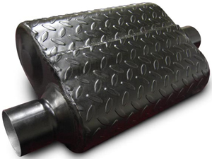

i am wanting to put a new muffler and everything on my jeep but i have no clue what is going to sound the best my jeep has the 4.2 inline 6 a lot of people keep telling me to put either the flowmaster 40 series or the 44 series on it if anyone has any advice please let me know
It's really hard to "give advice" here 'cause sound is so subjective. I hear what I hear, you hear what you hear. I'm running a stock exhaust system but replaced the OEM muffler with a Flowmaster Super 44 Off Road.
It's compact (cleared my tummy tucker skid) but kind of heavy since it's made from 14 ga. steel. I like the sound although it wasn't as loud as I even anticipated. I don't notice any disernable interior resonance either.
