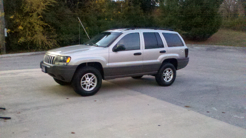

Currently have a bb lift by rough country. It was already installed when I got the jeep. The front is slightly lower than the back and i would love it to be level, I thought about just getting a new budget boost but would like a 2.5 instead of a 2 inch. . I like kevins offroad but just wondering if their is a solution or just get another one and if so what brands

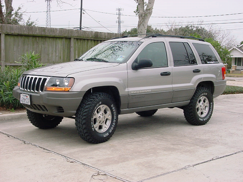

This is the kevins offroad

Well I think kevins is supposed to be a little over two, I want mine to be just like the pic. Think maybe v8 springs? Then kevins?
Im thinking mine is very close to the kevins pic except im running 245s and the tires on the kevins are like 265s or something
Kevin's off-road only manufactures a few parts themselves. I have had this exact discussion with Kevin a couple of times as I have been doing business with home for a little over two years. He is the one who did the lift on my 98 gc personally. About a year ago I bought a 99 gc for my wife and went over all of the options with Kevin on what the best budget boost to put on it. He suggested the daystar 2.25" leveling kit. The thing with most leveling kits is it usually ends up .25" less lift than stated. Also you will have to get longer shocks to accommodate the extra length. Again I must stress that going over 2" on spacers is somewhat dangerous. Google three wheel Jeep and watch what happens when a spring comes off when flexed due to too large of spacers rendering the bumpstops useless unless you are upgrading those as well which leads me back to just getting a rough country 3" lift that replaces the front springs and moves the original front springs to the back and includes adjustable control arms. This kit should be about $650. If you look at the price of replacing all the parts you plan on you will notice that the kit includes all you need minus extended break lines.

One more note. 2" of lift wont allow for 265s as the wheel Wells are kind of small but I believe the 3" RC lift will leave lots of room. Unless of course you are going to cut fenders.

I think ill look in to the daystar I read on kevins that his is a true 2.25, he may be using daystar? Anyways I def like the wj on kevins site
