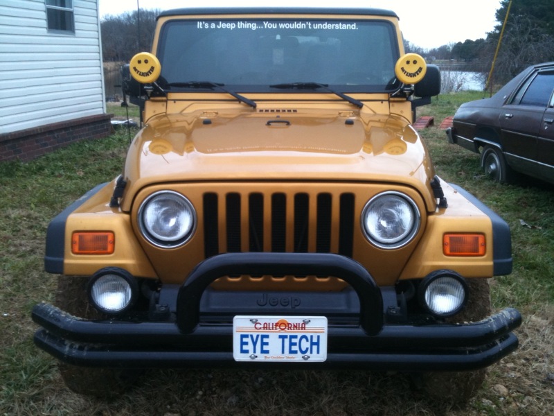

ok,tj jeep-winner,winner,chicken dinner!that's what i was contemplating doing,and it definately looks cool,which is what i was after!i am very anal about such things as that,and for 18 years i did custom car audio,so i know what cool is!i just can't stand something running through the crack of anything,when a simple hole gives such a professional,finishing touch to the job!looks like i will be doing just as you did!thanks for all the tips!as for the obstruction of pedestrians,you are right on the money,blkrubi88-i noticed that one right away!i also have some hood hinge brackets,and soon will add a second pair there,but am having issues with twisting the torx holes out,and will likely have to drill some damaged bolts out!keep on jeepin'!

Hey man, the lights look good! I have not hit a pedestrian yet, at least on accident!!!LOL

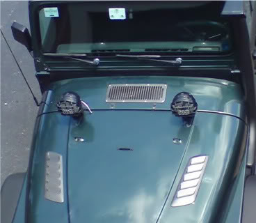

Located on the wind shield only causes a blind spot for pedestrians at Wally word!!LOL How did you run the wires for the hood mounts?.
Drilled a hole and used a grommet... Much like TJ_Jeep did on his.
Dont have any closeups, but you can get the idea from this one:
