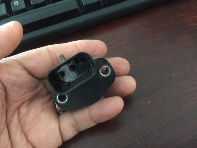

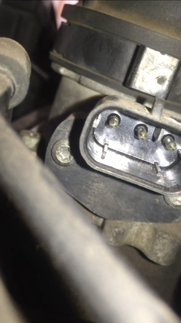

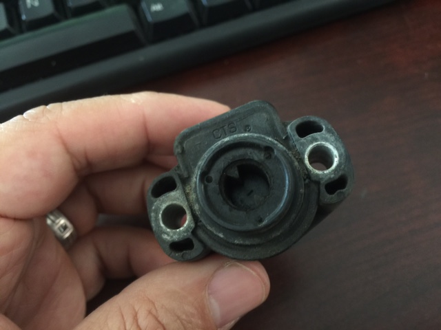

I drove My jeep for awhile now..and i haven't had the loss of power issue...however..while cruising to the car wash...i noticed a problem. As I lightly placed my foot on the gas pedal, i notice the similar issue of the jeep wanting to stall / coughing like as if it was clogged and barely getting any gas..but when I add more pressure to the gas pedal..it's find. So I fixed the long distance problem but now a have a short distance problem.
JPNinPA mention to check the TPS sensor...You were right..i hope.
Picking one up today and installing it: Will post my results.

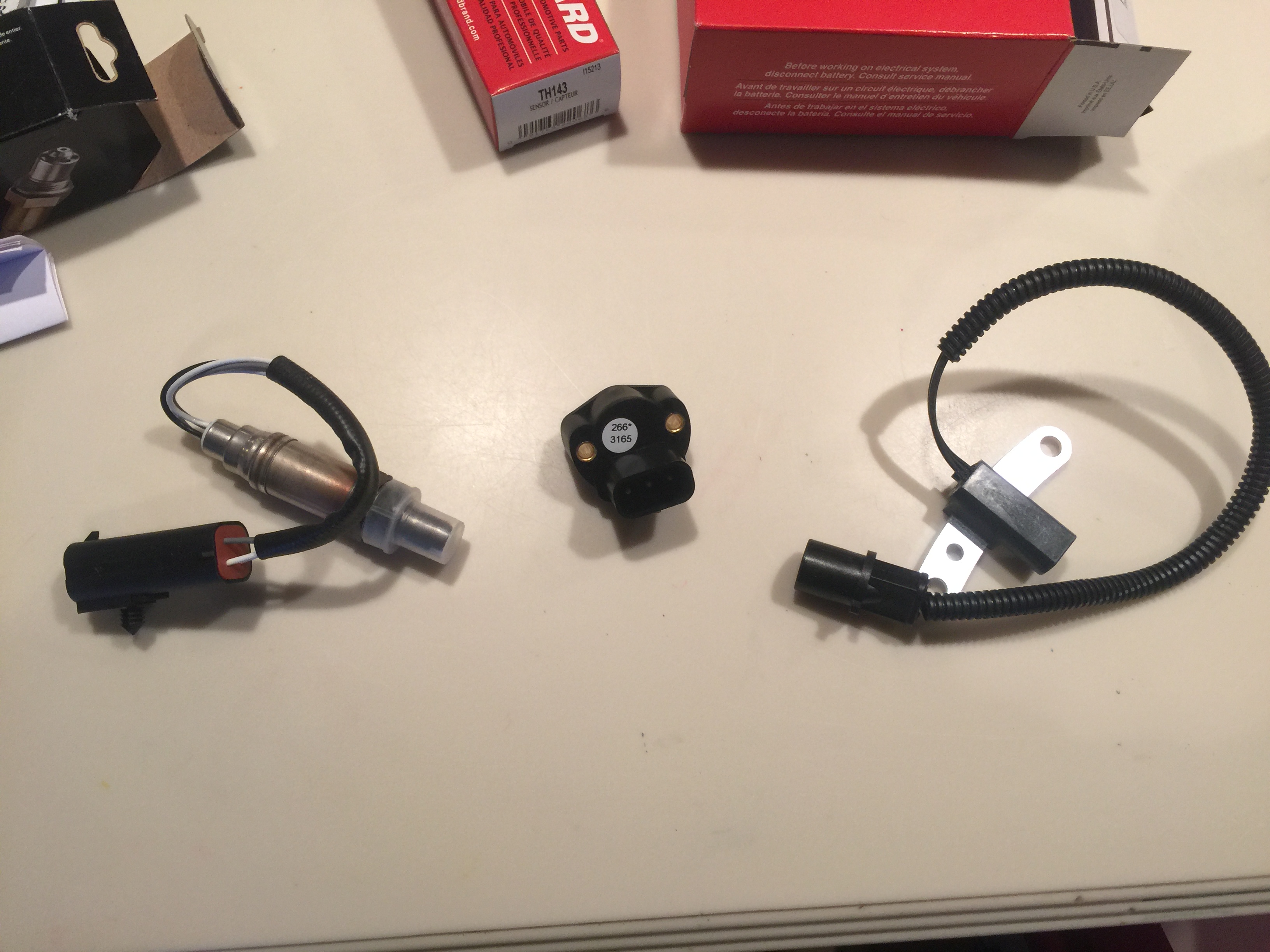

There is a cam /crank sensor which I ordered. I ordered the OEM From rock auto. Hopefully that solves my problem. Will post my results once arrived and installed.

Thanks for the info. I've been researching it on online.. it is the CPK.. Looking to purchase an OEM part from Rock Auot or Jeggs. Any suggestions? Hopefully this will solve my problem.
4/27/2016: I ordered and received a
New TPS,
New 02 sensor and
New Cam sensor.
