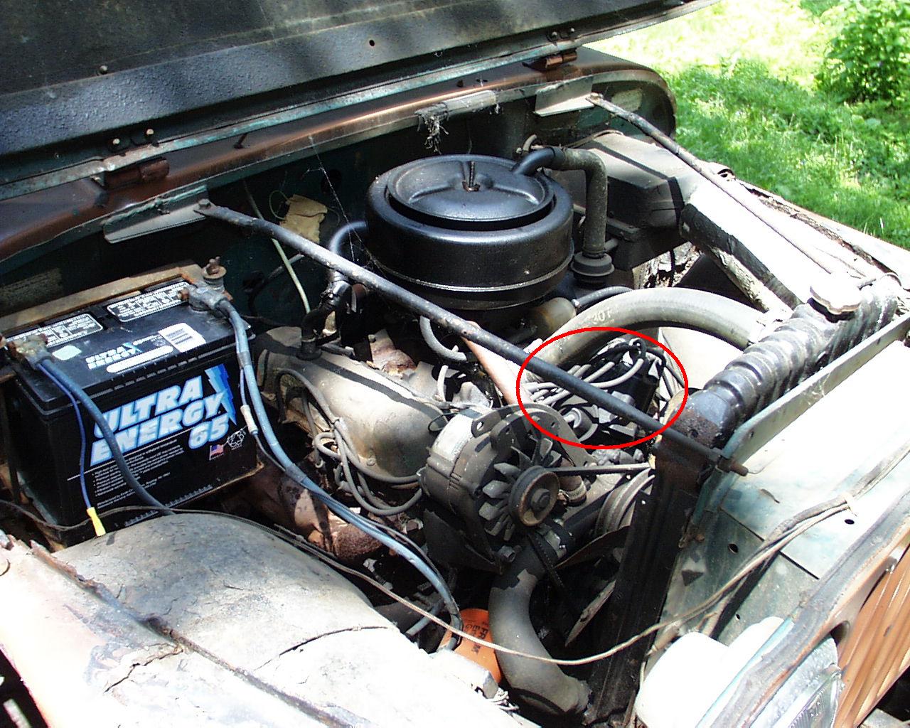

Ive got a jeep cj5 and i can just barely get it started but when I do i have to keep my foot on the petal. now i attached a picture, a buddy of mine said that the circled part( I don't really know what the name of it is) is faulty. so I need some help real bad and I know this isnt a whole lot of information to go on but any help you can give me is greatly appreciated.

That circled item is the distributor. There are numerous things that can cause a poor idle. I would refrain from just poking around in the dark as you could make the situation worse.
