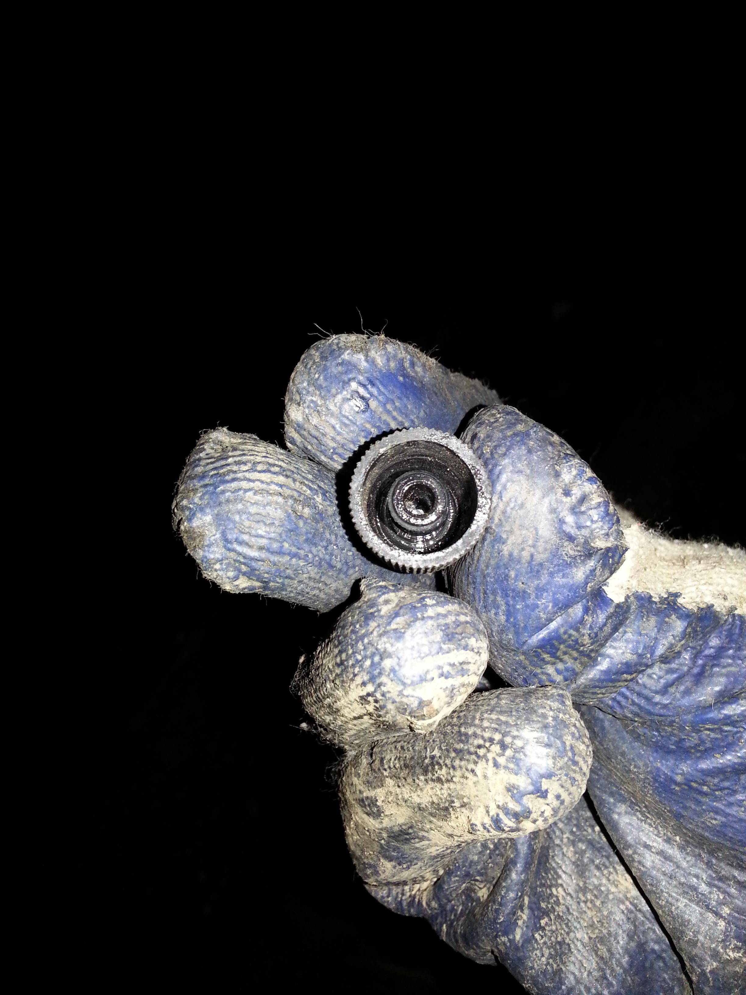

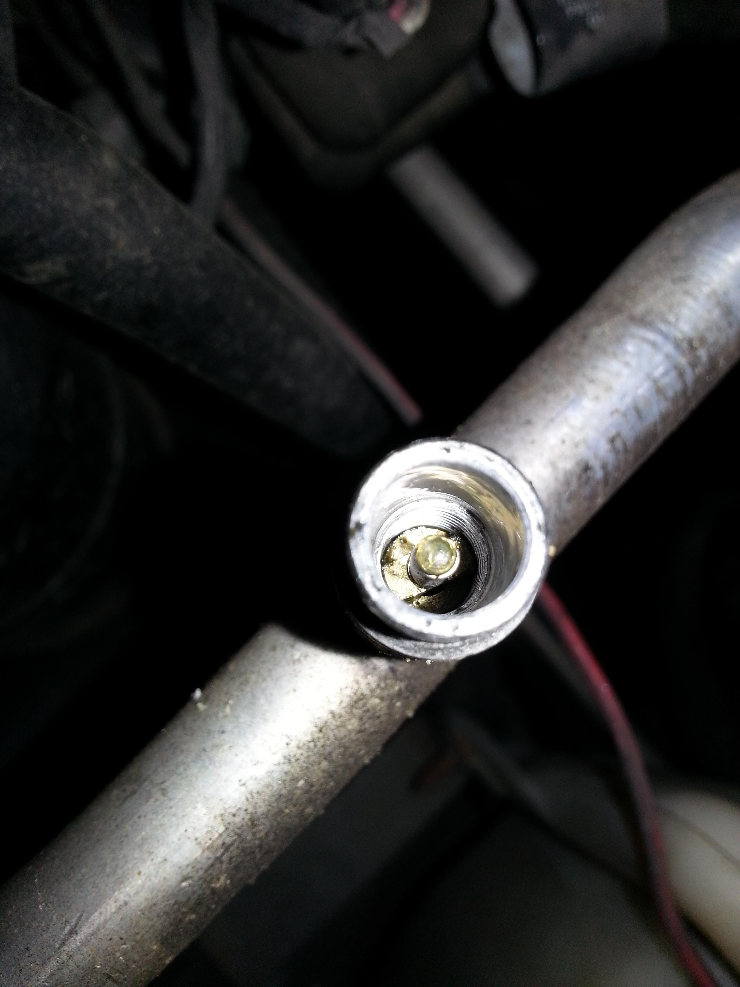

I have a 98 jeep cheerokee sport. The air conditioning coolant leaks. After doing some diagnostics, I detected audibly a hissing sound coming from the low input port, leading me to believe the schrader valve is leaking.How do I determine which valve core remover tool fits my vehicle? I have found one from Mastercool and one from Interdynamics. I am pretty sure I bought one of these before and it didnt work, because it supposed that the car had a thread around the outside of the low input port for it to "connect to", whereas on the jeep, there is no thread on the outside of the port, its actually on the inside of the port.
