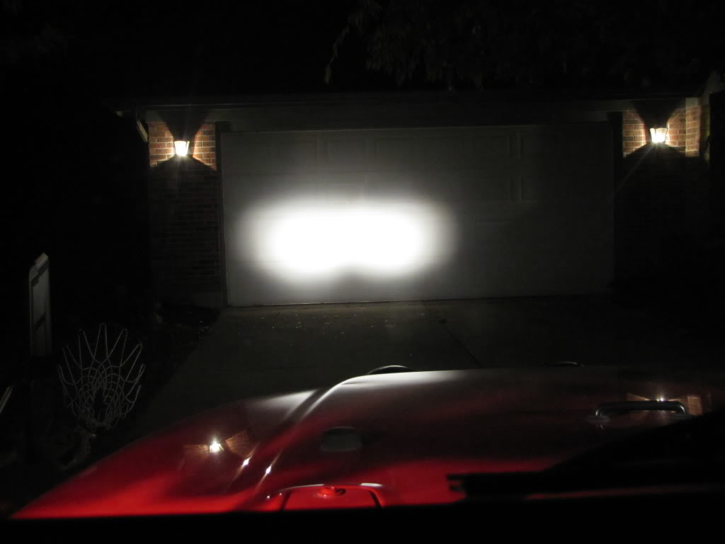

I aimed mine using the garage door method ( level approach ~25 ft back). Being long range and only off road use, I aimed higher than hi beams.

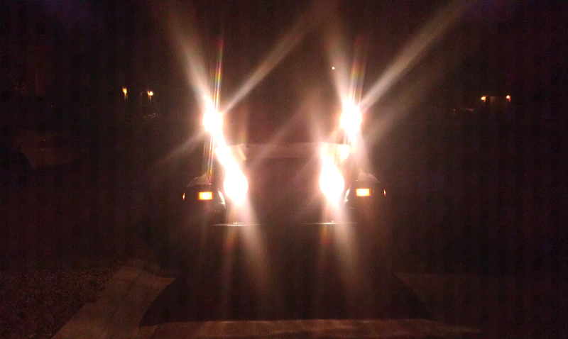

is it a good idea to use roof top lights for on-road driving if aimed correctly? i imagine they might be to high and might blind some ricers, im thinking of installing four lights, two for offroad only (aimed slightly higher for distance) and two for on-road use both wired to seprate switches, just wondering though, would they be up to high and blind anybody in a small car? and are the police gonna have their panties in a bunch over it?
Check your local and state laws. Some states you are only allowed four lights on at a time and none above the hood. Most brights and fogs can not be run together but brights and driving lights are o.k. as long as they are below the hood.
And yes anything above the hood will blind a lower vehicle if you have them directed to a useful distance.
The normal "law" states that it is illegal to have any clear lens light regardless of the wattage that is mounted above the height of the headlights. It might be different in Fla. But I'm sure you will still receive flack over it from the police if you are coming at them with daylighters on your roof mounted light bar, or even the windshield or hood mounted lights. The law also states that the maximum wattage for clear, forward facing lights is 65 watts, so therefore your 130watt is twice the legal limit. That is even if they are mounted legally down on your bumper or pushbar below the line of your headlights.

Well here is the results. I have a feeling that they can be brighter. Had the headlights on hi beam aswell
