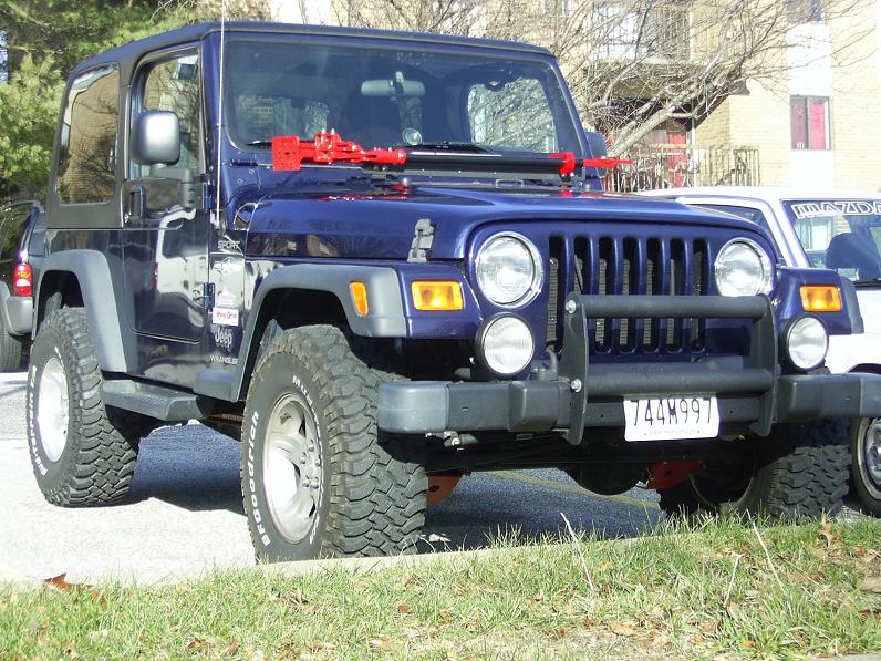

I got a Hi Lift jack and a Tough Stuff hood rack for Christmas, and I was just wondering if it would be ok to leave the jack mounted on the hood. I'm concerned about rain/snow rusting or otherwise damaging the jack. Are there any precautions I should take, or will the jack be ok out in the elements?

So is the red powder coat that it came in not good enough?
Edit: Now includes picture!

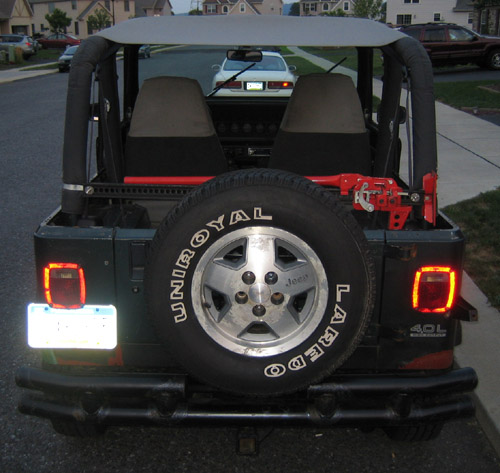

If you're overly concerned with rust and exposure to the elements, you could buy a black plastic case to put your Hi-Lift jack into. Quadratec.com sells them, as do other suppliers. I don't know if a case will fit your hood rack, but it's worth looking into.
My farm jack (not the Hi-Lift brand, but same design and function) is mounted to my rear uprights of the roll/sports cage. Total price for the parts was around $10. Plus, the soft top and hard top fit over the mounted jack, protecting it from the elements (when a top is on, of course).

can you explain how you mounted that. i got a 48" for christmas, and this is exactly what i was looking for.

I've got mine mounted like dandoc's, and it has always worked when needed. The majority of jacks I see mounted on the outside generally fail when needed most. Mount it inside if you want reliability from your hilift.

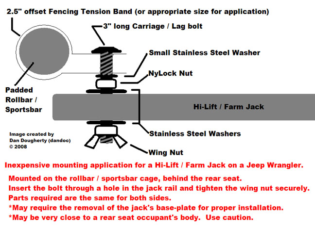

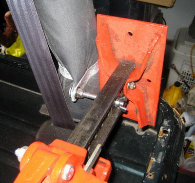

Hi-Lift Mount
I can't remember where I read about this inexpensive method of mounting a farm jack, but it certainly works! Your local "we've got-it-all" hardware store should have the parts necessary for the job.
Note the limited available space around the edge of the base-plate and the inside lip of the Jeep tub. To avoid potentially tearing a soft top, and to ensure you can remove the jack with a hard top installed, I suggest removing the base-plate and storing it elsewhere in your jeep. Enjoy! :-)

Did mine with ubolts and wingnuts, but same idea. Mine is out, used, and put away while others are still working on getting their jack out.

You probably couldn't tell in the picture I posted, but I do have a Daystar handle isolator installed. Had to trim the underside to get the jack to sit flush on the hood rack, but it works fine.

Re: Hi-Lift Mount
awesome, i have been looking at all the possibilities of where to put it, and this is exactly what i was looking for. thanks
