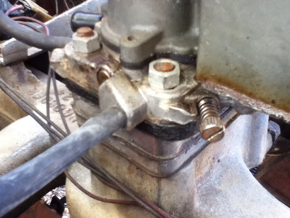

Today must just be a rough day, all around for people. Sigh, guess this part:
The little broken one.
It goes here:
See the broken end sticking out?

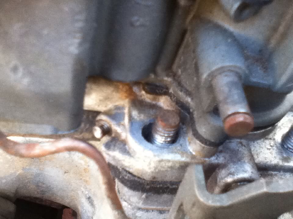

i wonder what happend to that screw that caused it to turn so hard. it was turning ok yesterday, a little tighter then the other one but still turned. then today, i tried to turn it in to find bottom and it wouldn;t move so i thought "crap, did i leave it bottomed yesterday? no, i couldn;t have, it almost dies when its bottomed out." so i tried turning it back out and off the end snapped. when i pulled the carb, it had a lot of white crystals around the end of the needle, i wonder what that was?

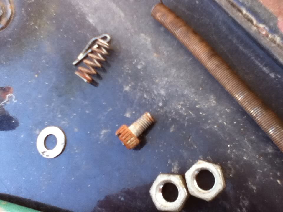

here is the good mixture screw

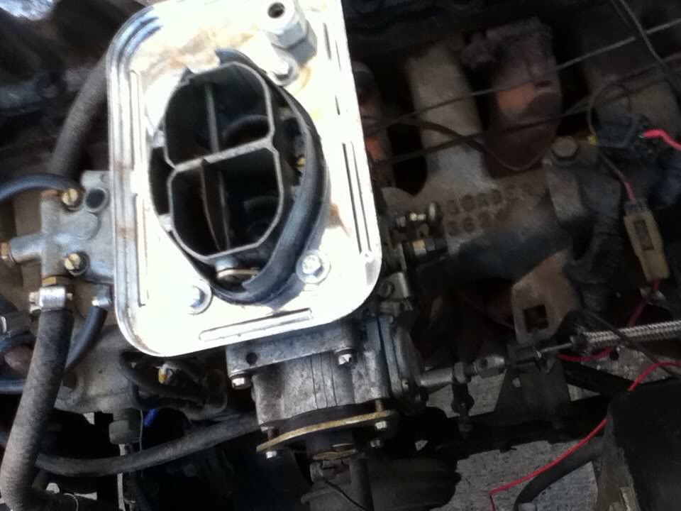

here is the weber getting laid out

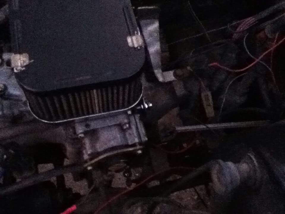

here is the big uh-oh. see the throttle cable end pulls towards the firewall. the carb pulls towards the passenger side and the old jeep accelerator pulls upwards down by the trans linkage.

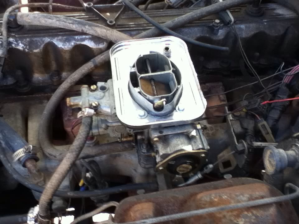

here is the old throttle making a 90 degree turn so i could drive to the auto parts store to get a universal off the parts wall.
i found out i also need to reset the trans linkage because i now shift at 2500 rpms, which is no fun. and, since the throttle was hooked to the old linkage spot on the trans connection, i could only get 60 percent pull on the carb. reminds me of the day i bought it and had to drive home 2 hours like that because the kid i bought it from did not know how to hook the carb up when he replaced whatever was on it from the previous owner. that is the reason he traded me for my cherokee.

see it, all by its lonely self
I believe the white crystals are ormed over the years from moisture in the fuel. I know that the powdery stuff is oxidation. A chemical reaction between aluminum and another material (like brass or bronze). If that screw broke and you need it to be drilled out, don't take chance of ruining the carb. See if you find a machine shop in your area to drill it out for you. If you not ind one, PM me and I will give you my address. I will take it out for you. Any way you look at it, you need to take the carb apart do drill that screw out. It might be a pain but is doable.
By the way, not a bad idea to sometimes take them mixture adjustment screws out totally, clean them out ad put just a tiny drop of white grease on the threads. Perhaps once a year. Remember that one carbs might be 15-20 years old and nobody touched them screws in years..... Aluminum doesn't rust like steel but corrodes in it's own way just like any other metal. I might not not know much about other stuff but I know a thing of two about metals after working with them for the past 43 years of my life....... LOL
Have you srayed the crap out of it with some type of penetrationg oil and put some vise grips on it to see if you can work it out. I would try that and if it snaps flush, then drill it. I have seen the adjusting screws at O'rileys auto parts, they were behind the counter on the wall.
I was thinking putting some penetrating oil on the threads, cutting a slit in the end, and seeing if I can back it out slowly.
