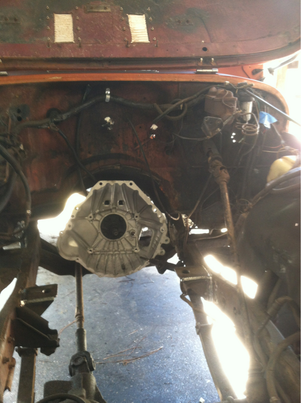

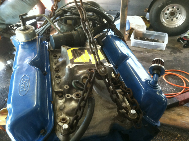

so after months and months of saving, research, and planning, we finally started the install of a ford 302 into our cj7. despite what the research says the t176 didn't just bolt right up to the 302. we spent at least one month and 3 different bell housings to get those two to hook up. now we need a nee shift fork. more pictures as I get them and I'll edit this thread with more details once I get to an actual computer.

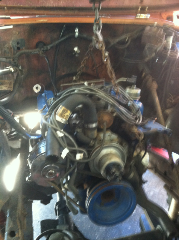

got the motor installed. fuel lines ran and carb lined up. got the wiring semi mapped out and next weekend hopefully we will get the motor started up. all that is left to buy now is a slave cylinder for the trans, battery, and exhaust.
