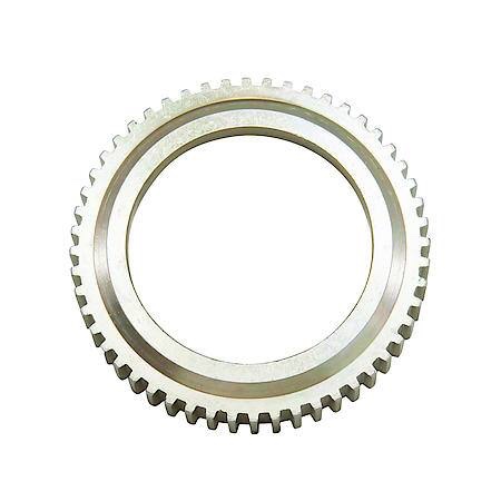

Have you cleaned or inspected the tone ring?
Debris or a crack in this will cause issues. Also be sure the sensor is fully inserted with the correct gap .
