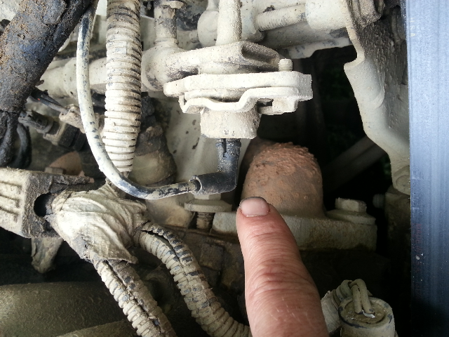

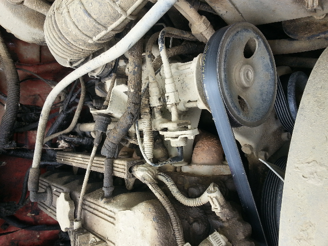

Also I found a bad vacuum boot yesterday.haven't traced the line yet but I know it is leaking.
As mentioned above, the CAD on front axe. I have had people in the past tell me my 4x4 wasn't working before, I asked them if the other side was spinning and it was, I just had to ask..
The boot you point to is vacuum to the Fuel Pressure Regulator on the fuel rail.
