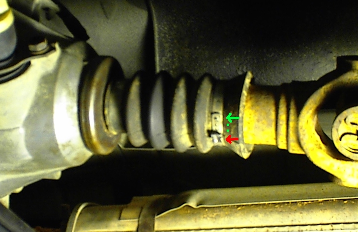

On my drive line there is like a boot thingy on the end where the yoke goes into the transfer caes. how do i get that off without destroying it? there are like weird metal bands that look like they have been cripmed on somehow.

and about the boot thing, well it dosent have any kind of screw, and I know what kind of tabe you are thinking about but it isnt them!! LOL. the kind that are mostly found on radiator hoses I believe are what youa re thinking about. these are just fing weird!! LOL there is like a half tab (about 1" in length) that wraps back around the rest of the band but it dosent look like it could be folded back and slipped through. i know ill go and take a quick pic of it and show you what I am talking about!! ya!! LOL

After seeing your photo, the boot does look tight.

yeah its pretty tight! !LOL I gave it a tug and it jsut extended the boot all the way out, but wouldn't let me have the yoke! !LOL damn thing!! LOL
maybe I have to cut the bands? I am kind courious why the kit came with 4 zip ties, no wait those are probably for the shocks!! he he

Hi,
So I looked at my Wrangler (which has the boot), and it looks as though it is the same type of clamps which you have.
I took a picture of it (which sadly isn't any clearer than yours), and drew on it. The red arrow is a separate piece which looks like it is squeezed to tighten the clamp. The green arrow and dots indicate places on mine where there are little hooks/bumps which hold the clamp together. It looks to me like you need to compress the main part of the clamp so the hooks will push in and disengauge from the piece with the red-arrow-pointing thing on it.
Hope that made any sense. LOL it's so funny how the little things can drive you crazy. :mrgreen:

thx man!1 yeah it does makes sense and I will go out in a bit and give it a shot!! hoping for the best.

worked like a charm!! LOL

there is a tool used for those band clamps... go to autozone and ask for a cv boot tool and you should get what you need to do it properly... make sure you talk to the store manager... most redshirts there don't know what they are talking about

I live in a small town and we dont have a autozone round here!! have to go to checker. but I got it out and didnt damage anything so i guess that is a plus. but on the topic of renting items, I am probably going to have to get a spring comprosser to get the mamouth coils to go in there homes!! I couldnt believe how big they are till i got them. 24" tall unsprung. that is a long ways to even attempt trying to drop the front axle to get them to fit. not tomention that it might be a little dangerous doing things without the comprosser!!
