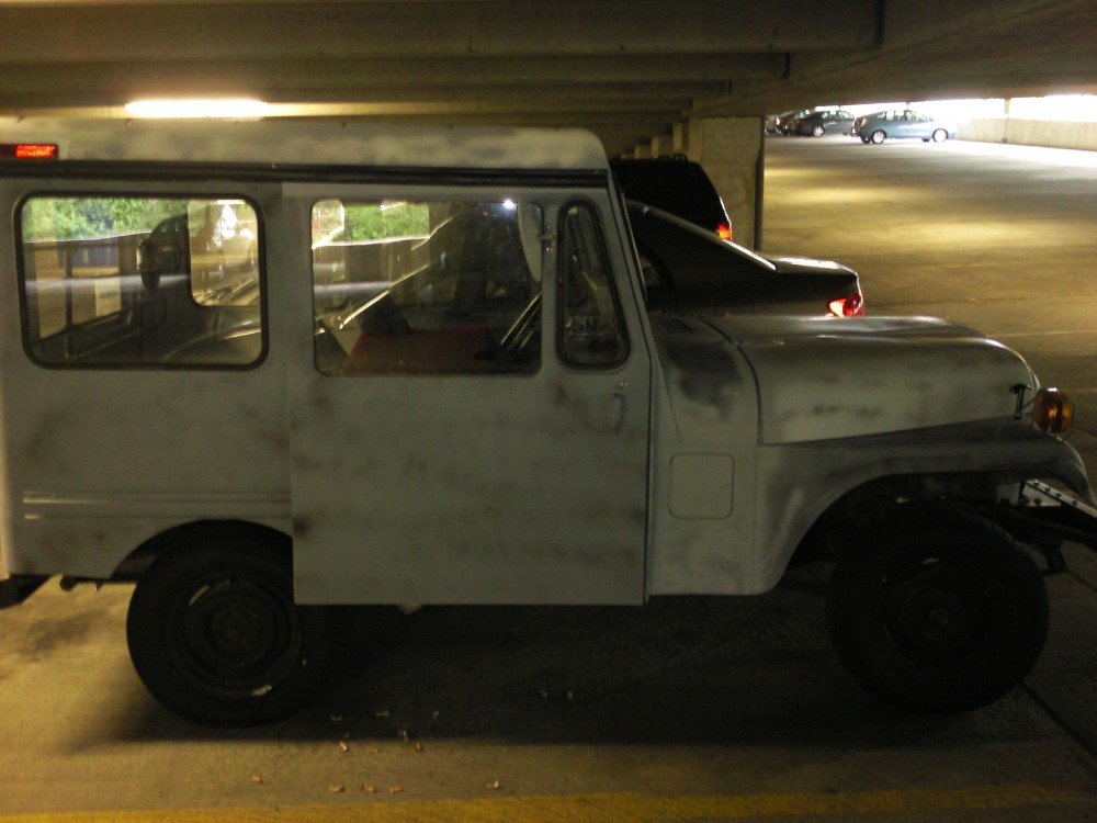

My 83 DJ5M will idle fine, but when I throw it in drive or reverse it chokes and won't acclerate, and at stops usually dies. I didn't have this issue before I got it to the house (just bought it a few days ago).

did you ever find a solution? I also have a 1983 DJ5M and have a similar problem. Mine runs great except for this problem. sometime, when starting it take a few times to turn over as if fuel isn't getting to the engine. also, sometimes at stops it idles so low it stalls. as long as my foot is on the gas it runs great. my carb was just rebulit and that doesnt seem to be the problem. have you ever seen this link about the recall for a pinched fuel line?
Google This: AM GENERAL DJ5M Recalls, Defects
could this be it? if we both have this problem it could be a defect with the model.
