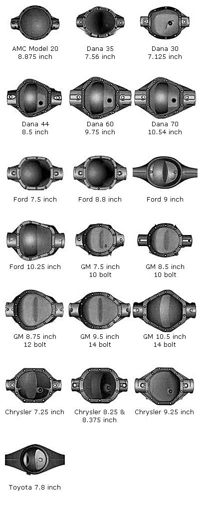

How can I determine which diffs my '79 Wagoneer has? Apparently there are 2 choices- Dana 44 or Dana 60, correct? Which is more desirable? In particular I would like to know which rear-end it has because I am going to figure out a cheap disk brake conversion if one isn't readily available.

seems like a visual inspection of the diff cover may let you know. im not positive on that though.
try this
Wagoneer has either a D44 or AMC20HD rear axle. The D44 is more octogon shaped and the AMC20HD is big and round like a basketball. Front axle is a d44.
You don't find the D60 rear until you get into the 3/4T J-trucks like the J2000 and J20, or larger.
Thanks for the chart. I looked at the bolt pattern before posting this, but they both have the same pattern. The 60 is obviously much bigger/beefier.
Thank you Bounty Hunter.
Edit- Mine has the D44 in front and rear. Thanks again.
