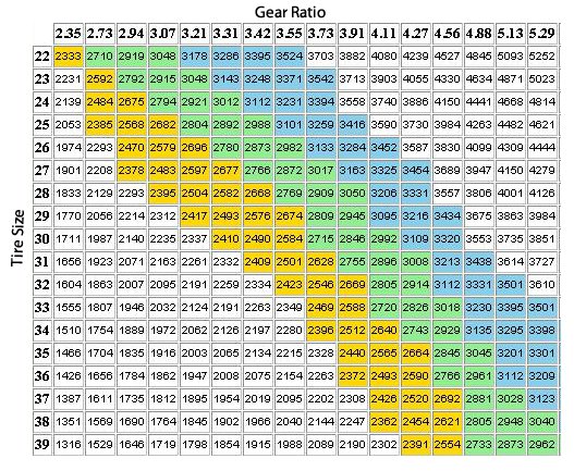

Yellow = Highway Driving, Good Fuel Economy
Green = Daily Driver, Best Overall Performance
Blue = Most Power and Towing, Reduced Fuel Economy​
As you can see in the chart (borrowed from Quadratec), with the change from 3.73 to 4.56 on 35's, you've gone from just barely too little gear to the conservative side of a good choice for a daily driver. 5.13's would have given your rig some extra grunt in the low end but your engine would really be screamin' along at 70-75 mph and your mileage would suffer. Personally, I thing 4.88's are pretty much the sweet spot but you'll get a lot of different opinions on this, as well.
Also bear in mind this disclaimer that the above chart "is based on 65 MPH and a gear ratio of 1:1, on a manual transmission in 4th gear. Please NOTE: If you have an automatic transmission your RPM will higher due to slippage in the transmission and the torque converter. With an overdrive transmission your RPM in overdrive will be 15% to 30% less than indicated."
