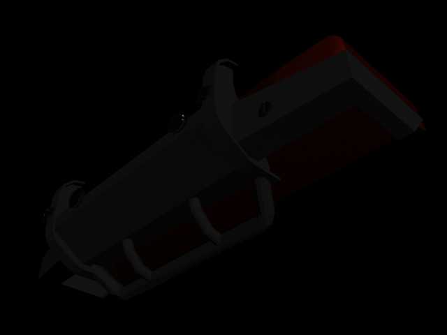

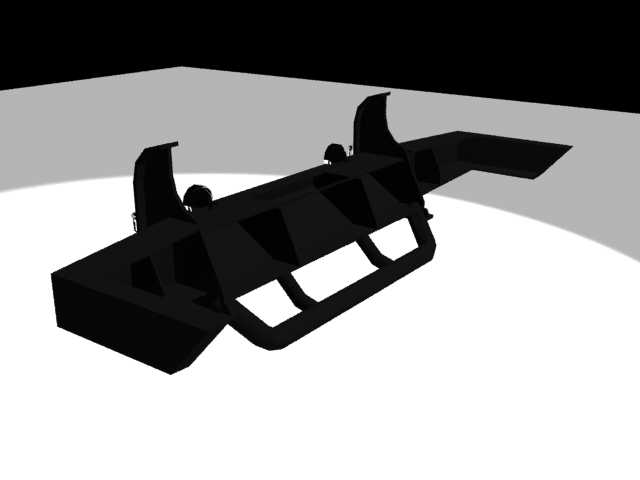

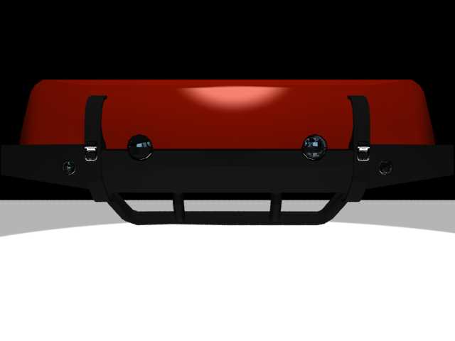

Here are a few renderings of my first draft of it. Lots of work to do still but the design is getting to be something im looking for. bumper bottom 1st draft.jpg[/ATTACH][/ATTACH]

That's a nice looking bumper. I started making mine with a heavy piece of C channel. About 4 ft long. Cut and bent the ends at about a 40deg.s. I'll try and get some pics posted later. It's nothing special, but it's cheep, and basic. Kinda let's me be creative later down the road as far as adding to it.
you should also consider weight. also if offroading approach angle. mine i built is a little to long for the approach, modifying later.you can see it in the tj reader rides
According to my cad program my current design is roughly 412lbs. What is considered "too heavy"?
Am planning on reinforcing my frame with c channel later on when I do a long arm. Am looking into the type of style that Rusty's Off-road has so I don't think weight makes a ton of difference. I've never done this so you tell me. How does it drive the same with an extra 300+ lbs loaded on the front? Will be balanced out with a rear bumper later.
the weight makes a difference if in mud/snow. floating on the top is better than sinking. my bumper weights in at 175lbs
412 lb is WAY heavy for a bumper, consider using thinner metal where strength isn't as much as an issue. 412 is heavier than the 2.5L engine, so imagine it as the weight of another engine.
•2.5L I4, 340 lbs.
•4.0L I6, 515 lbs
Ok thanks guys. Target weight is 175. I thought about certain parts being aluminum and removable since it will inevitably crack instead of bend. Aluminum is abundant and free from my work so I might look into that to drop some weight. Ill have to calculated it again. Maybe I screwed up.
I like it. I think a hoop in front of the grill would look better than the bumperette Idea but I could be looking at the picture wrong. Kinda hard to see on the iPhone. To lose some weight I would shorten the side skirts for better tire clearance and I would make the top from a thinner metal as it's not really structure just looks. Just my 2 cents. I wish I knew cad.

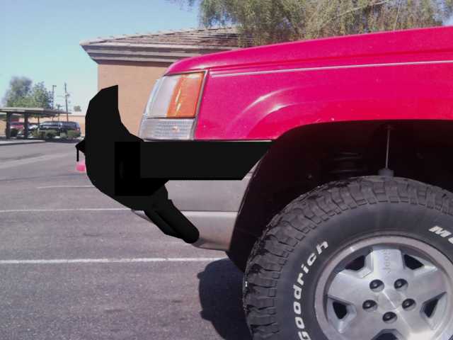

Here is a reference pic I just threw together.

one suggestion,i made my hoop from left over muffler pipe. seems strong,yet light weight. i have slid into a tree, no damage. looks good, just try to lighten
Nah. That's like me picturing everything at different exposures and apertures lol. Photography is my biggest hobby. I think that the bumper would be one of a kind. I can't wait to see some more.
