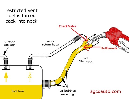

WoW this is some really good info from all members !!! I am going to change the oil to 10-40 and replace the Mopar oil filter with a new Mopar oil filter plus get a new gas cap. I would like to point out that this jeep is hard to fill up at the pump, you really need to go slow or it pops off ? What could cause this. I really should have started a thread called Making 02 Grand RR aka Road Ready So far I have had the 4 windows fixed at a local body shop for one hours labor. It was the cable in the drivers door, I guess after so many years the cable in the drivers door just wears out, WD40 then spray greased the 2x 4x selector so it would come out of 4x4 drive. Replaced the driver side rear tail light assy with a new one because the old one had one bad screw in socket. replaced steering stabilizer and high speed balanced the front tires which stopped the DW. AC check OK Heater check OK Stereo check OK. The main bearing leak is so small that I will drive it for years before getting that fixed. All in All this is a super sweet ride, it must of been one driver highway miles only. any work that had been done must of been by a Jeep Dealership.. lots of new parts and no hooky rigs.. its a nice chage finallay

the pump kicks off often suggest a vent valve issue AND P0455 showed a TSB that may help both

Wow typically the new gas cap fixes it. It fit properly and tight?
The gasket in the cap gets worn, damaged or dirty causing a leak. The leak doesn't allow the evap system to trigger the code.
Look for cracks in the lines or for loose fitting lines to the canister.
That hole in the filler should have a tube attached.

two points: first after market gascap often fail, for the price, I always buy them from a dealer to avoid chasing ghosts. Second, that canister with the hoses is another primary issue to check. there is a vacuum solenoid under the hood that goes from the engine to that cannister, check the function of the solenoid and all the hoses for leaks. You may have to drive the jeep up to 100 miles after clearing the code to ensure it is fixed.
