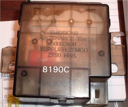

I’m getting the code 62 on my 1994 Jeep Grand Cherokee Laredo 5.2l V8..I’ve replaced the pcm about 4 months ago along with another bunch of sensors which seemed to fix my issues. I just can’t find much info on this code 62 EMR mileage not stored.

"62 - Emissions Maintenance Reminder (EMR) triggered by mileage accumulator"
This is the EMR under the dash. Reset, remove, or replace.
