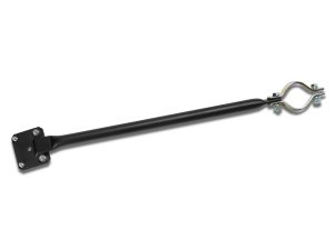

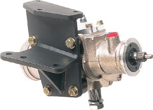

Sounds like the steering box at the frame. Consider a steering bracket like this:
With a brace to the opposite framerail like this:
