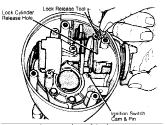

Any ideas on ingition cylinder???
JohnF
The first couple of times through I put up a clean table (board on a couple of saw horses) and laid the pieces out in order. I also made a few notes. Not brain surgery but it can get confusing.
If you have trouble getting the cylinder out without the key there is a trick that I've never tried, that may or may not be relevant (I've always had the key).
