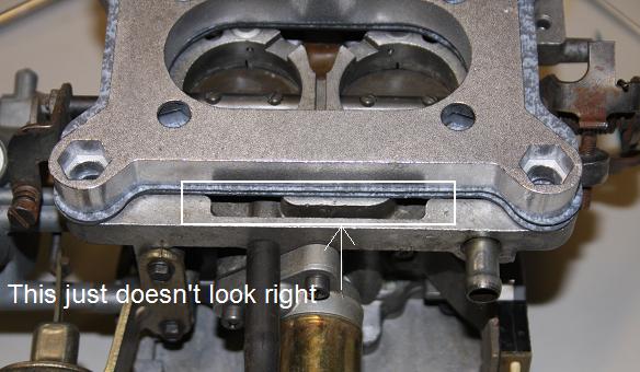

Hey...I bought a 2150 off of eBay a while back and am trying to fit it on a '84 258. Problem is the adapter plate doesn't match with the bottom of the carb. One entire section is wide open. I can't imagine it is supposed to look this way. Another issue is the clearance on the power valve cover screws. If I double the gasket, it clears. Any insight on this?

You must use a gasket made for the carb, not the adapter. I think there is usually a big, 1/4 in. thick, rubber/cork/whatever gasket that is between the 2100/2150 and a V8 manifold. If you find one, use it; it clears those powervalve screws. If you just use a regular 2100/2150 gasket, then you must grind down two spots on the adapter so the carb sits flush.
Also, you might have noticed how much smaller the inlet on the manifold is than your new adapter. I took the 3/4 in. plastic spacer off the manifold (the stock one that is blackish gray), "port matched :lol:" that to the adapter while keeping the bottom of that plastic spacer the same, and stuck it back on. The idea is efficiency, but I doubt it did much. It looks cool, though.
