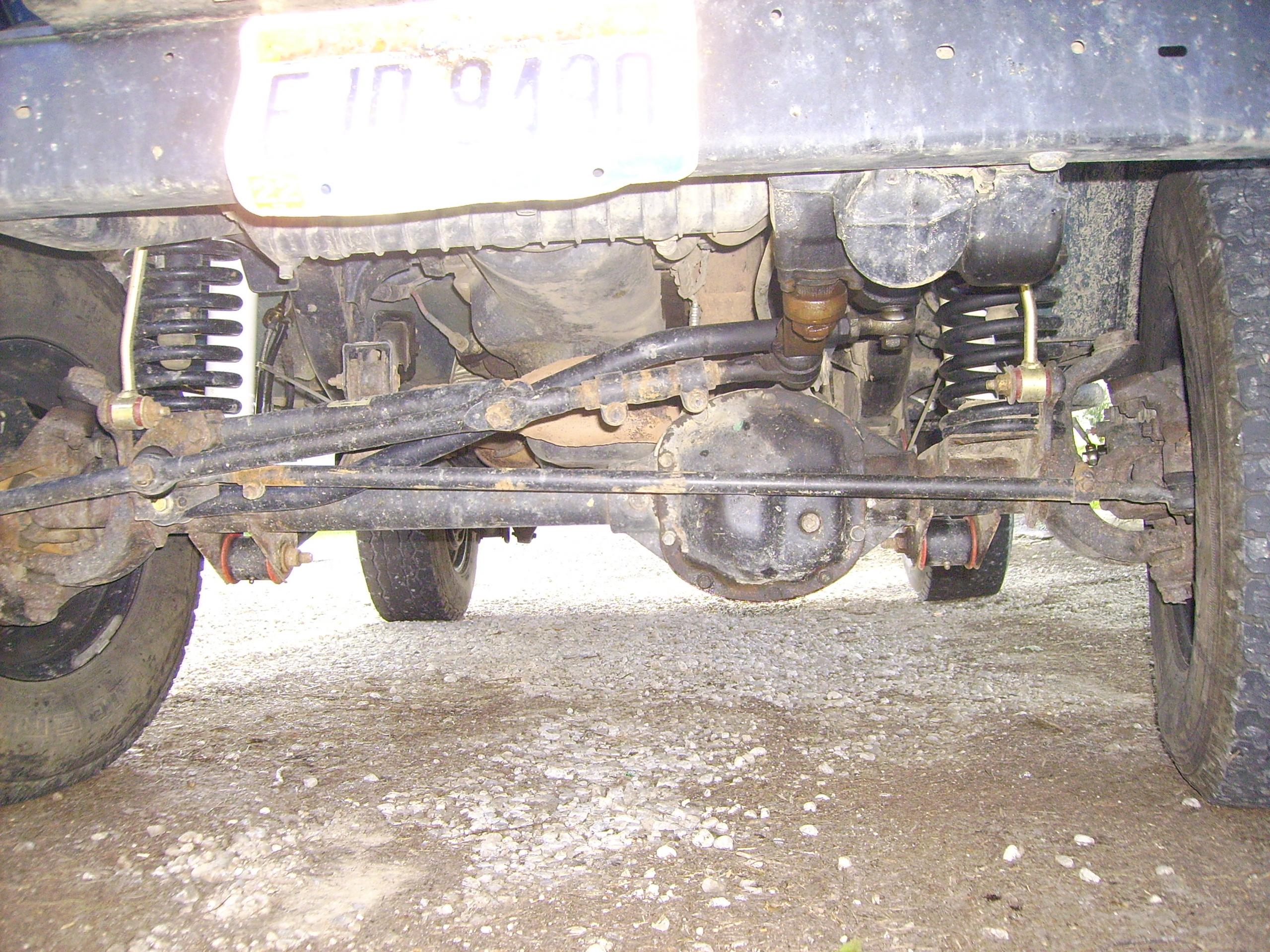

Can you post a pic of your steering linkage and trackbar from the front?
I would remove the drop pitman and put the stock one back on, chances are it will bring your trackbar and draglink back to parallel and remove bumpsteer. Often times a drop pitman arm isn't necessary when an adjustable trackbar is used.
here you go

here you go... It's a li'l muddy but this should show you everything

Yep, trackbar is at a steeper angle than the draglink. Reinstalling a stock pitman arm should bring the top end of the draglink up and bring everything parallel again.
I agree with BH the track bar and drag link need to be as close to parallel as possible. Looks like you need to buy a new pitman arm. What TLCJ5 said holds true for a CJ steering, but not a setup with a track bar.
I wonder why the TJs went to an inverted Y steering setup instead of the inverted T... Also if it were my jeep I'd build a bracket to reduce the track bar angle instead of trying to increase the drag link angle to make them parallel.

Really no good spot to build a bracket to modify the location of the trackbar. The frame end bracket is cast, and the axle end is below the centerline of the axle and the stabilizer prevents it from moving upward.
