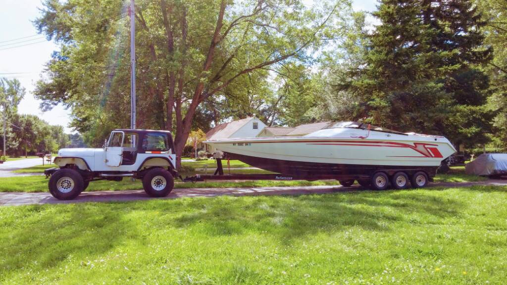

Built a 78 cj7, stretched wheelbase,52 inch Chevy Springs, dana 60, 14 bolt rear, Amc 401with adaptor plate to dodge nv4500 with dana 300 strapped to it. Fiberglass tub and fenders. 37 9 ply military humvee take offs mounted on aluminum 16.5 wheels.Replaced heater fan motor with 1993 full size blazer unit. Way more air. Marine gas tank behind rear seat. Holley 650 carb. Aluminum radiator. 410 gears. Yj flat fenders.
