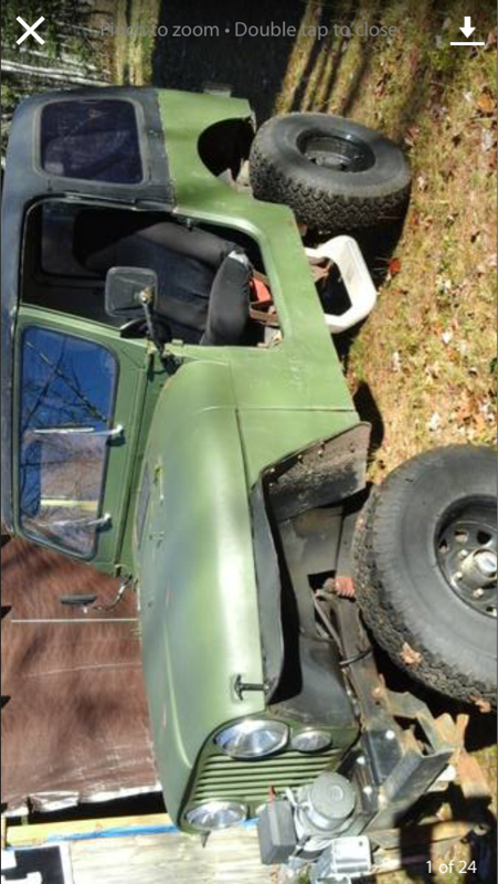

Thanks guys, I am currently looking at a 1981 cj7 258i6 for $4999 and it has a new motor craft carb new 33 inch tired and rims. I live up in Upper Michigan, so the rust is a big deal (cause of salt on roads) but the frame and steel body are in good shape, little to no rust, I haven't went and gone and checked this thing out yet but by the information I gave, does it sound like a good deal? Thx
Also my dad built a cj7 Frankenstein, which is basically a 1976 Bronco chassis with a cj7 body, and a 5.0 302 v8 motor and it is cool, but we only use it for the woods trail driving up at camp. But my dad knows a lot about the jeep stuff, he also had an xj, so anyway he can help me out when buying one. But he thinks I am a dumbass for buying one of these for a dd and thinks I will have to fix it all the time, but that is the point right? To learn.
