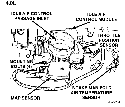

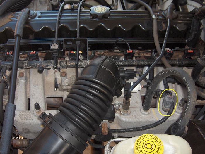

Wow! Thank You JPNinPA. Good information and great photos.

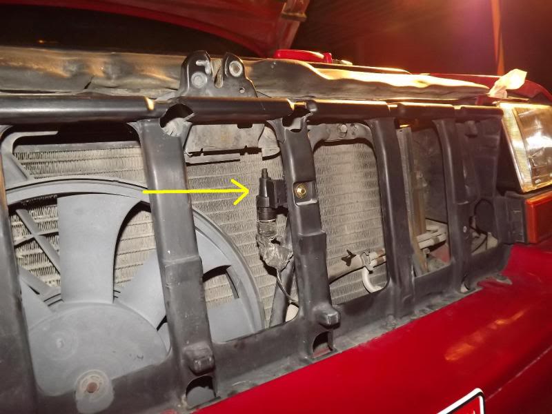

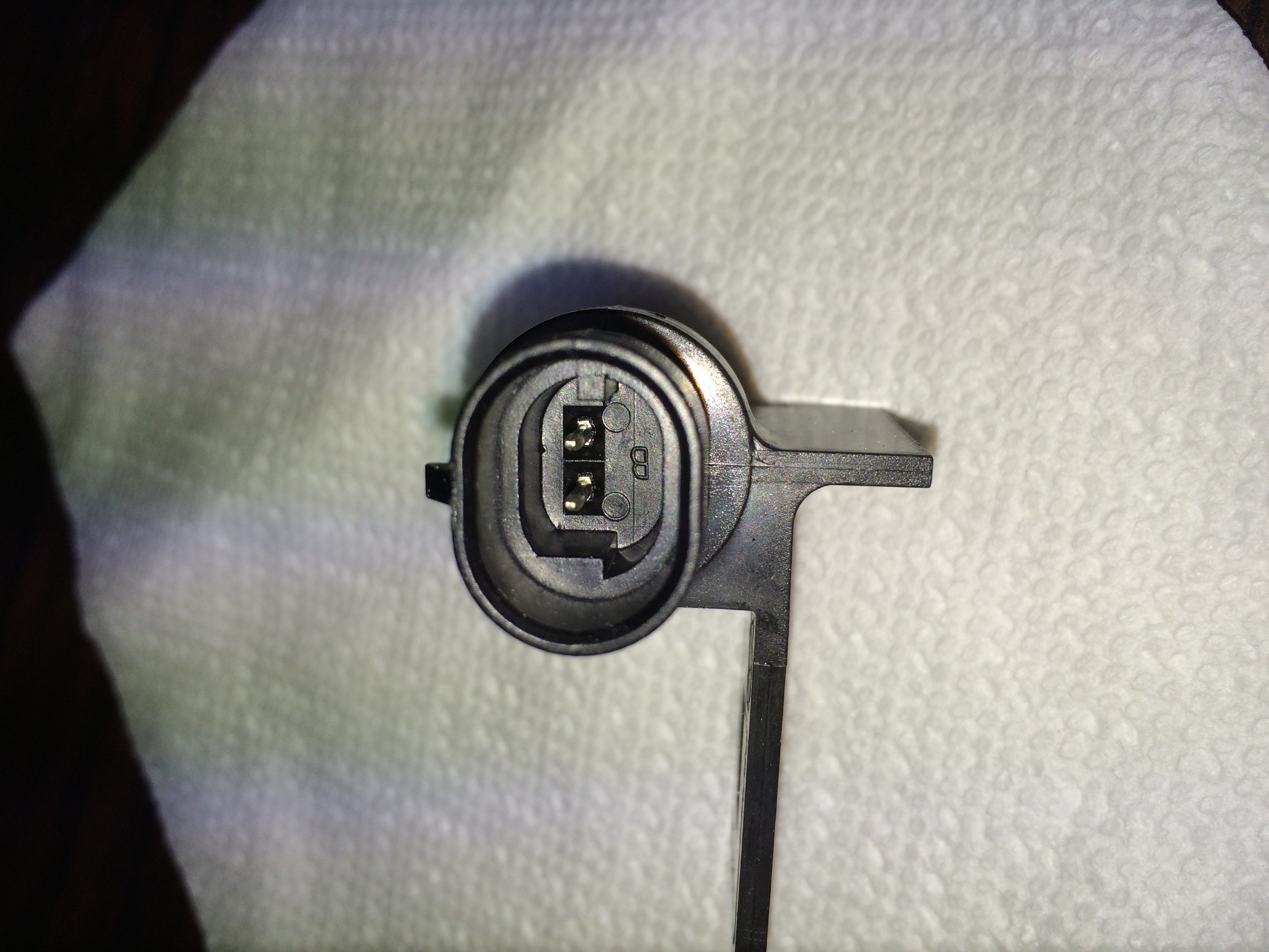

What I am looking for is the "ambient" air sensor. It is mounted somewhere with a bolt.
I will attach photos so you can see.
Thank You, NDININ.

You da man.
Would never have guessed.
Thanks JPNinPA
