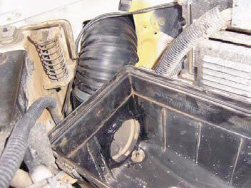

Using this picture for reference (not sure if its exactly the same...) but if u look at it, the rectangular filter sits at the top of it (above the circular hole there...)
now, when i cut mine, i just cut the "bottom half" of the airbox OFF, basically, below that hole. i was careful to not disrupt any of the mounting points, you dont need that thing floppin' around in there!
