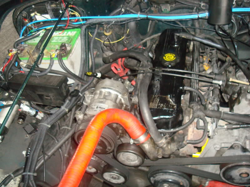

OK, for fuel pressure, there is a rail (a pipe, if you will) on the driver side of the engine (this is where the injectors are; my injectors are the little yellow thingies to the right of the valve cover, the bright black thing in the center).
On the rail there should be a schreider (sp?) valve; think of it as a bigger version of the valve you use to fill the tires. Take the plastic cover off, and press the center of the valve. Just like the air would flow out of the tires, if you have fuel pressur (make sure you turned on the ignition with the key to prime it), fuel should flow out (use a rag to avoid spilling gas all over the place!).
