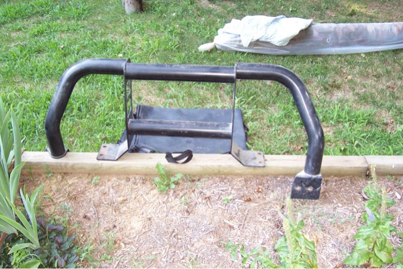

I was hoping someone could tell me if this push bar on Craigslist would fit on my 2005 rocky mtn edition tj. Everything is stock but I want a push bar or brush guard for wheeling. If not, any suggestions on a cheap alternative? Money is an issue unfortunately. But less than 200$ would be ideal.

you can make it fit, the frame mounting holes will need to be hogged out a bit, IIRC you will have to hog them out enough so that the forward most holes will have to move inward about 1/4" each and forward about 3/8" each. the other two holes will not come close to lining up. Another option is to weld up the current holes and just re-drill the holes to match you tj frame.
and please, for the love of god, do not mount any tow points, or use that brush guard as a tow point.
