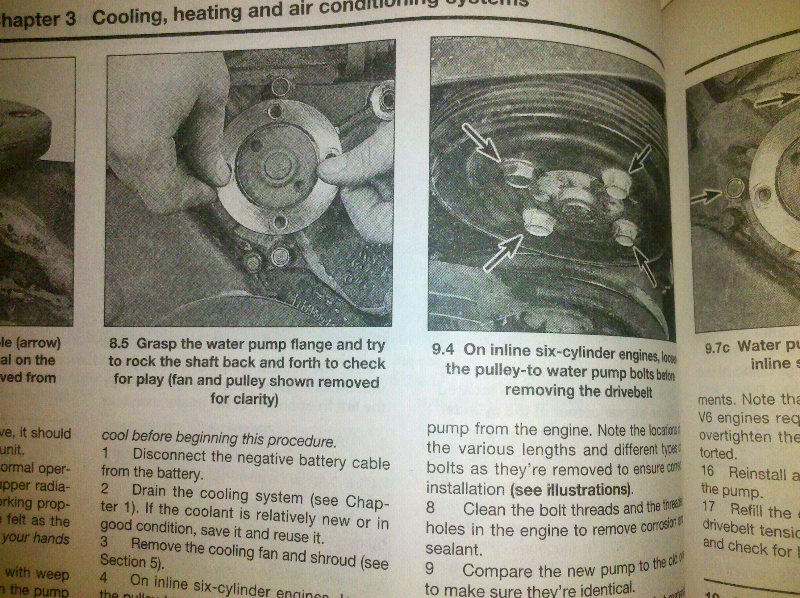

I have a good illustration, let me try and find it

Loosen pulley to water pump bolts , then remove belts, then pulley, loosen clamps and remove hoses, remove brackets from pump, do not remove any hoses from ac or pwr steering, remove bolts and water pump, remember where each bolt went because they may be different lengths, good Idea to clean em too. Then reverse the steps with the new pump
