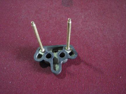

I've taken out the idle tubes and they are already 0.032 .
I guess these are the venturi tubes (see attached pic).
Hmmm. Was hoping that would be the quick fix.
Not sure whether to make them even bigger or not.
Comments on this appreciated.
Once I put it back together I'll try adjusting the Carb.
However, when I had it smogged I had the mechanic check the timing
and adjust the carb.
If I keep the rpms up over 5K it seems to idel tolerably, but below that
no go.
