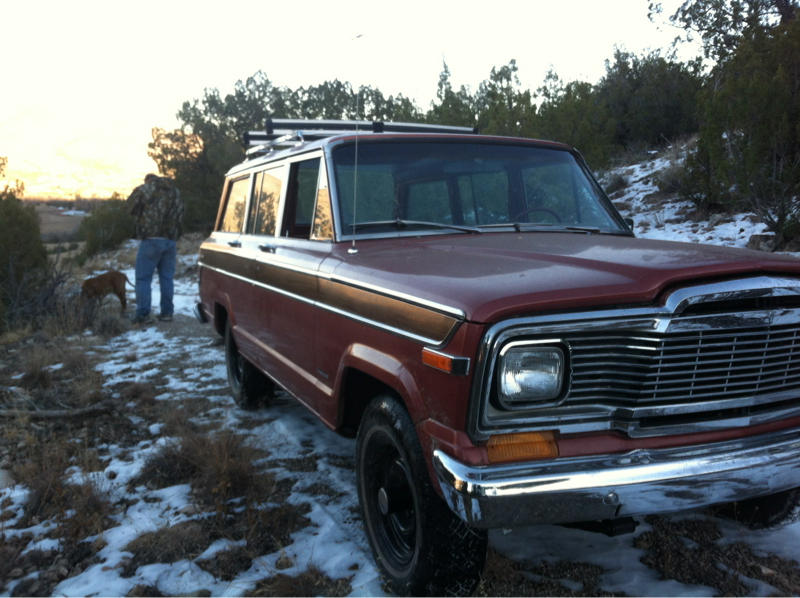

We just Put the motercraft 2100 on this wagon... Got it on eBay ...it's a factory reman... Ran ok but I was miffed because it didn't run great ! Then once I got all the vacuum leaks stopped it finally ran like its suppose to .... But that could be at least part of the problem. Hope this helps... I think we found it by searching for a motercraft 2100 for jeep 360 :)
