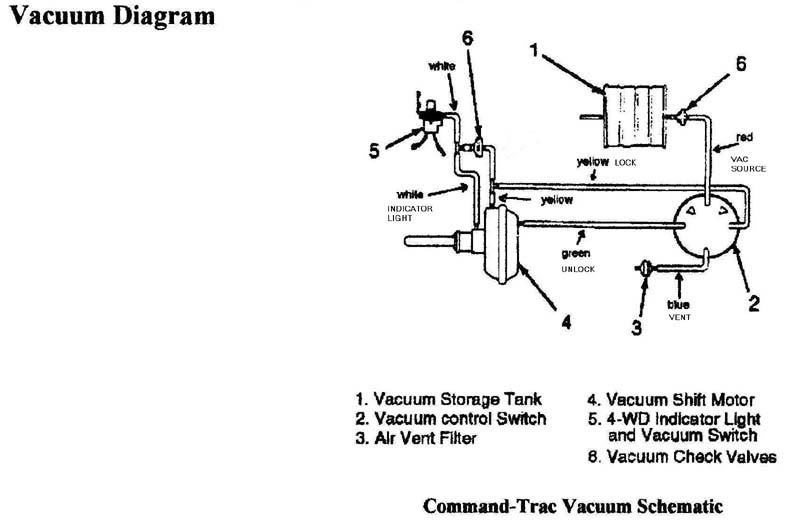

You can google "Posi-lok" if you want the cable deal (I chose this), or you can re-do the lines (cheaper).
If you go with the re-do, here is a diagram;
The storage tank looks like a black plastic baseball, & the control switch is on top of the transfer case.

All YJ's have the vacuum disconnect, and your '92 is slightly different than the diagram above. Your 4wd light switch is on the front axle and not the firewall as it is on earlier YJ's.Your 4wd light will likely work when the disconnect is working properly and is engaged. You can unbolt the disconnect from the axle and, with engine running, watch the fork movement when shifting from 2hi to 4hi.If it's not working and you need 4wd in a pinch, unbolt the disconnect from the axle and slide the shift collar to lock the 2 axleshafts together. Install the disconnect upside down and it will keep the shift collar engaged.
