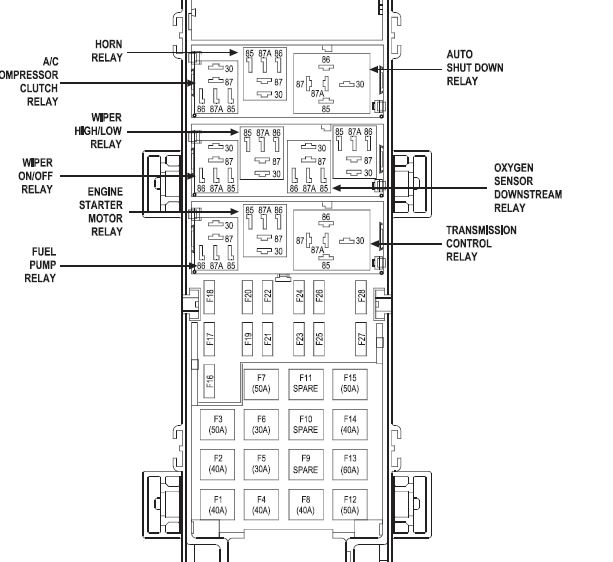

The only code that shown is P0354 for cylinder #4, possibly a wiring issue with that or a bad coil. Also the fuse #6 keeps blowing so might be a short someplace and will be checking all the grounds connections as well now. Would timing issues cause the fuse to blow ?
Are you using a scanner?
Fuse #6 underhood or in cab fuse box?
No to timing causing a fuse to blow.
SWAG - wiring issue - pinched grounded harness -
Yes, also was diagnostic done at the Jeep dealer. The #6 fuse is the small yellow one in the fuse box under the hood. I will check all the ground wires for any kinks and possibly any contact on them that shouldnt be. Thanks.
I do not think you have a problem with grounds - more likely a power feed ie coils or inj. on
bank 2. The coil for cyl 4 is a clue.
Look at diagram confirm which fuse - #6 is a 30amp and a major circuit - ASD is the main circuit for jeep.
