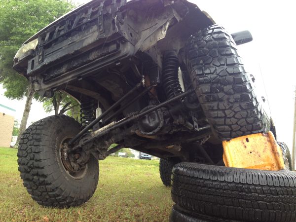

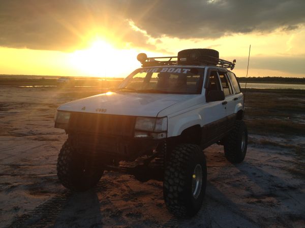

so i asked the guy what kind of lift it has, he said "its all custom, the previous owner and his buddy who builds grand cherokees built it, its all coil, 7in front and rear, and a few months ago i added 1 3/4 coil spacers to the front to level it out." also what are some way i can tell if it has had proper maintenance so the engine will last longer?
pics of jeep

Can't tell much about the suspension from the pics but it's deff seen some trails. I run heims instead of tie rod ends on mine as well but they aren't exactly DOT approved. I'd check things like oil, transmission fluid, coolant, power steering fluid, air filter and such and you'll see how well it's been taken care of. In the shape it's in it looks like a toy someone has outgrown and honestly 3k would be top dollar for it around here.
