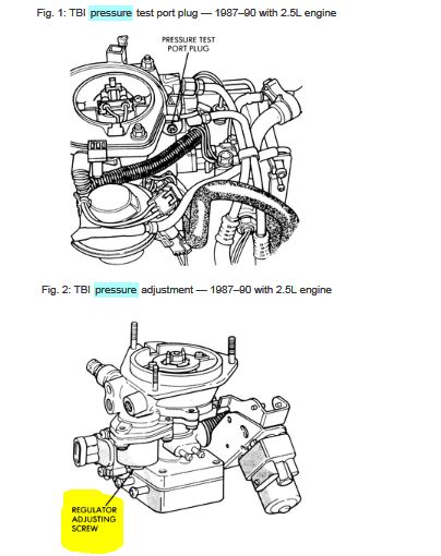

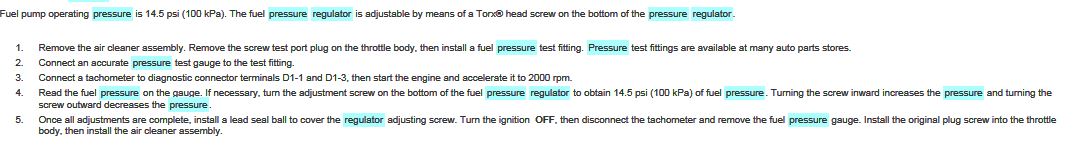

start engine then What is pressure at @2k rpm?
yes I have. but I will try again. I have also checked and tested both of the rollover valves as well as replaced all the rubber tubing that plumbs them.
My bad I missed the TBI in your post -
ignore step 3 use tach in vehicle

4. and lastly I can not adjust the pressure on the fuel pressure regulator per your last suggestion due to the fact that there is no adjustment screw on the bowl of the regulator. besides I have 15psi at start up like I should right?
