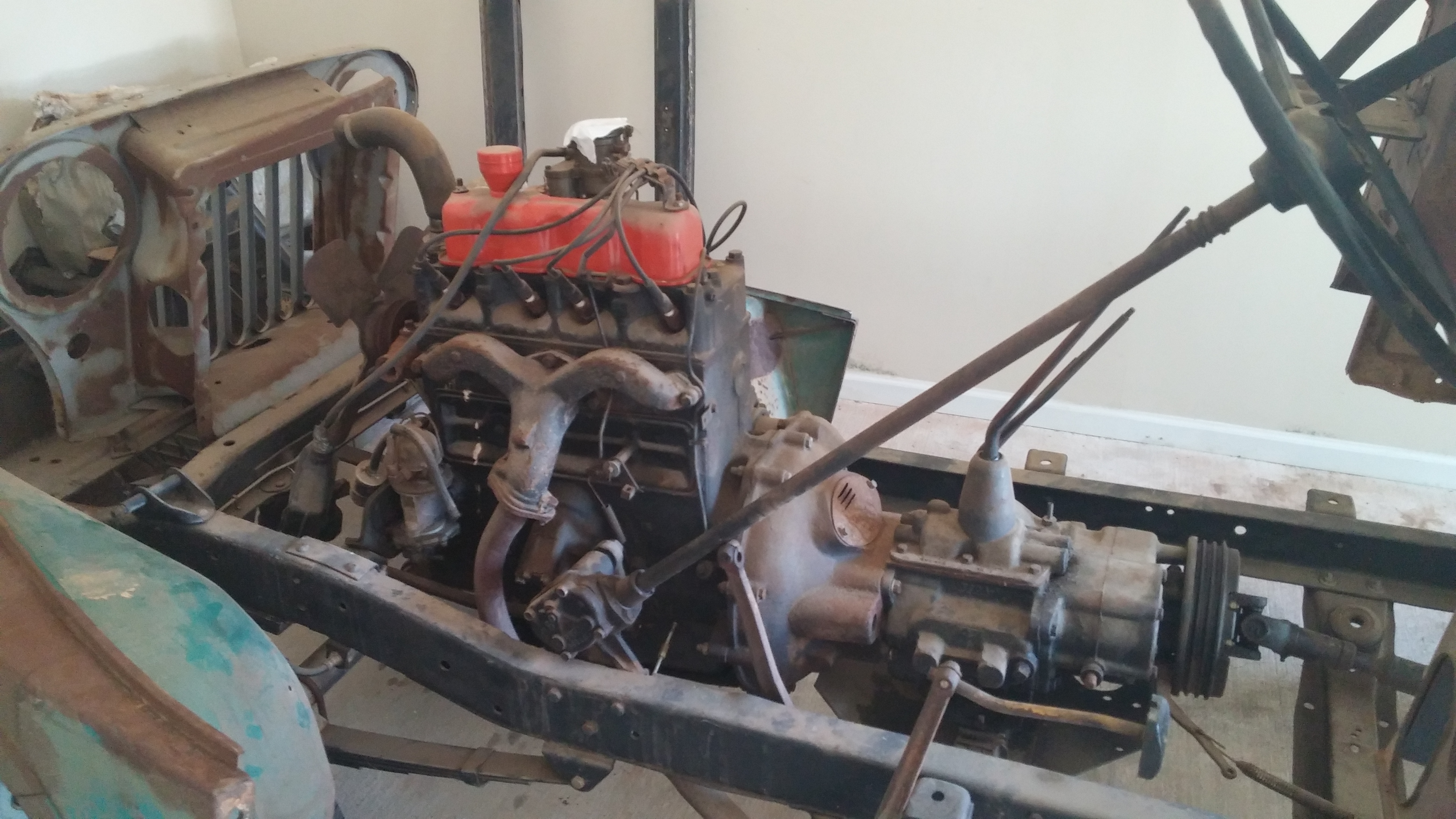

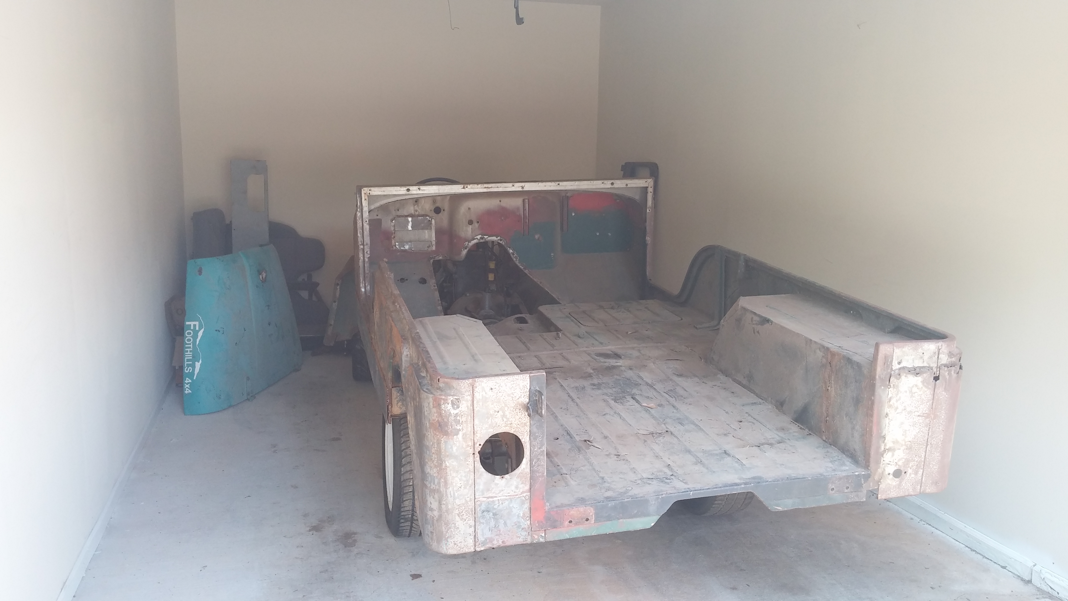

So what I have is a 1964 CJ-6 with a rough body and solid frame:
Needs some patch work and bondo but should do nicely, the narrow track axles will have to go though

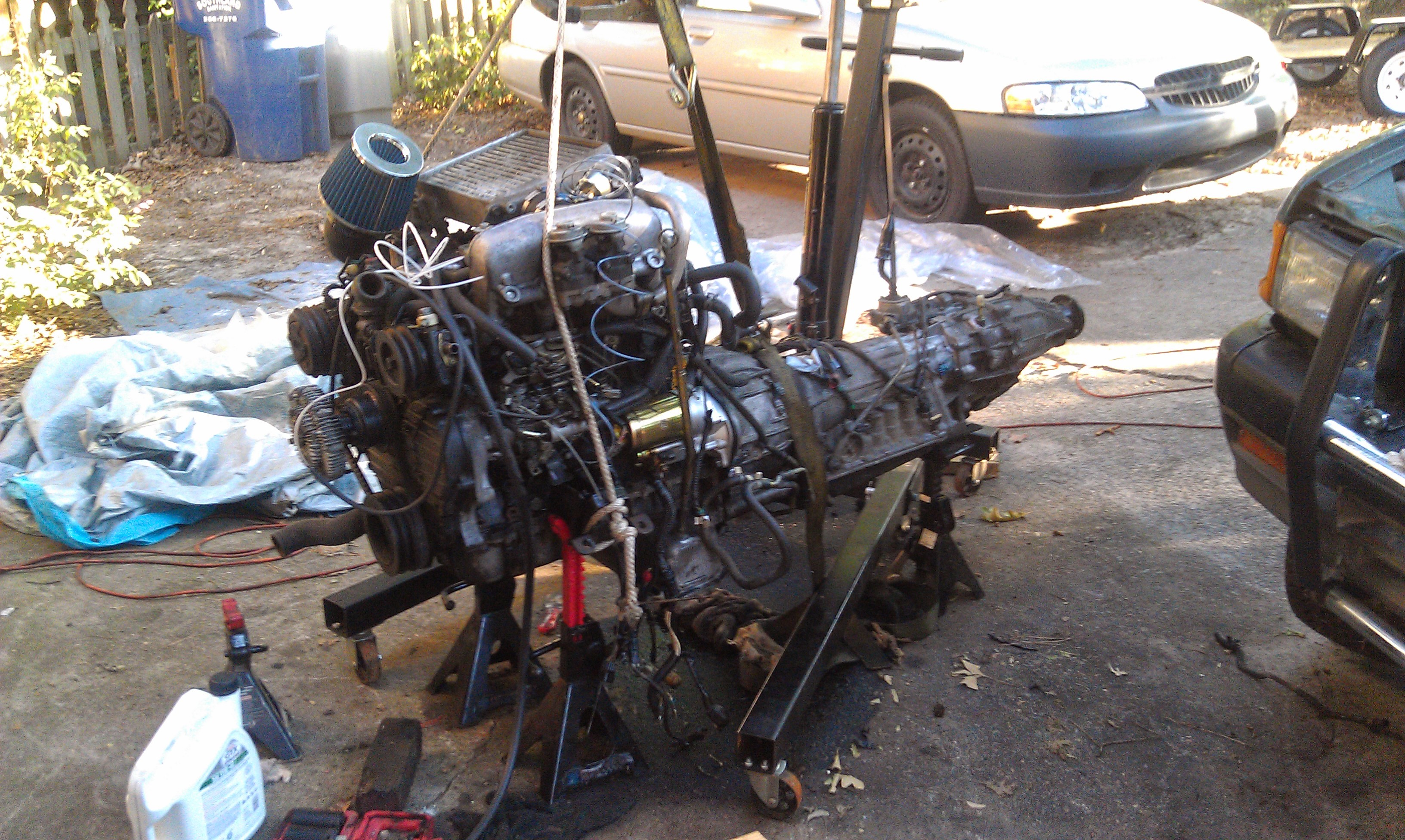

and my old friend, a 4JG2 3.1L turbo diesel mated to a re-geared version on the 4L30E, I have run this engine in an I'll fated truck before and it is solid as they come with torque for days.
