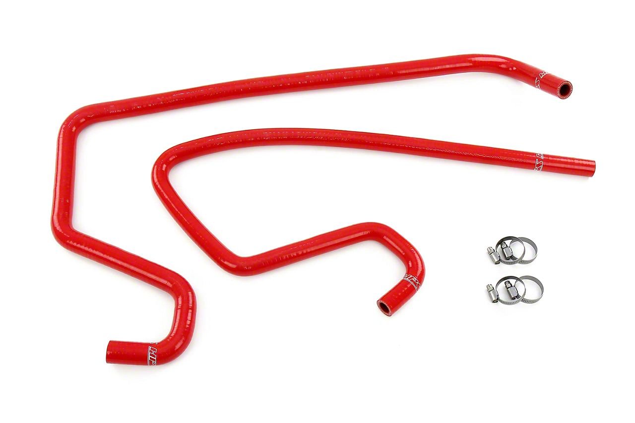

Are these it in amazon?
What a weird link it made. I tried again here:
Hmm, thats odd
Thanks for this. Sadly they are not what I am looking for. This is a far more complex set up with crimped metal pipes.
My needs are much more basic, just plain rubber tube with preformed bends to wrap round the back of the block.
